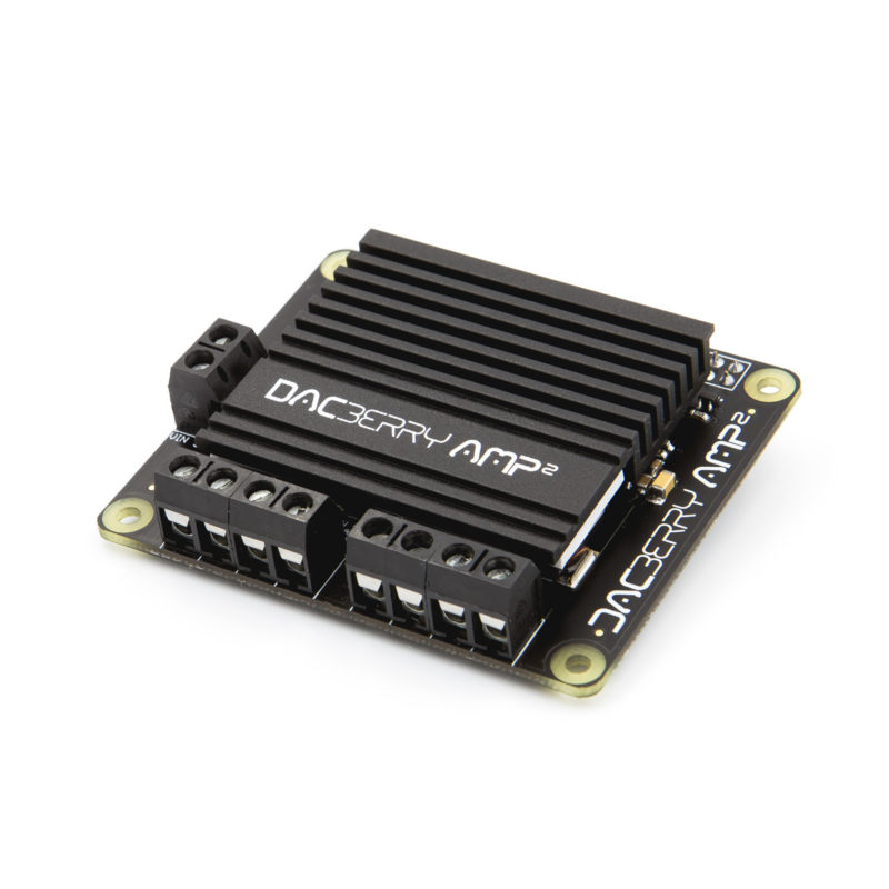

i could tested a prototype of a I2S RPI DAC AMP. a 4 channel x 60W 192Khz Class-D Amplifier that works with the Piano 2.1 volumio driver! Dual Stereo and dual mono! DACBERRY AMP2
osaelectronics.com/product/dacberry-amp-2/
