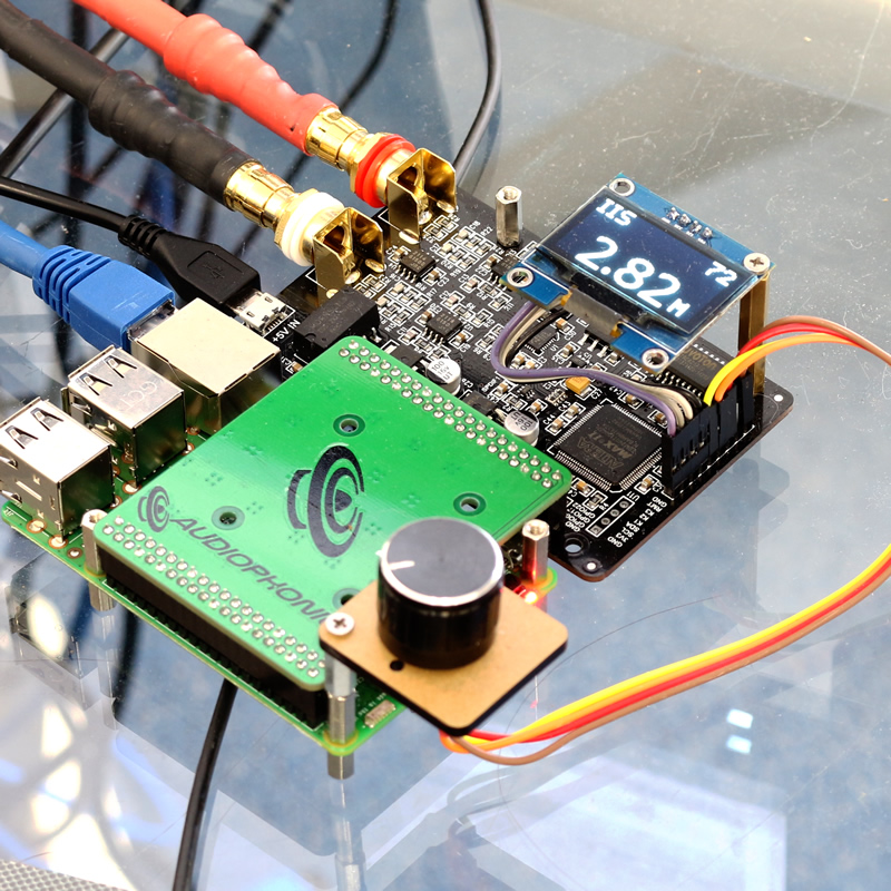

Audiophonics released new DAC:
AUDIOPHONICS DAC I-Sabre ES9038Q2M Raspberry Pi / I2S & SPDIF / PCM DSD
audiophonics.fr/en/diy-dac/ … 12795.html
- chip SABRE ES9038Q2M, 32bit DAC, new patented 32-bit HyperStream II architecture, accurate volume control
- I2S in
- SPDIF in!!!
- SPDIF input accepts PCM format up to 24/192 and DSD 128 DOP.
- I2S Input can accept up to PCM 32/768k and DSD 512 DOP.
- High quality analog output with two 9J NJM 2114 bipolar operational amplifiers
- ultra low phase noise crystal as clock
- DVCC is supplied with LP5907 (<6.5µV noise)
- AVCC is supplied with a dedicated ADP150 (< 9µV noise)
- can be connected oled display and rotary encoder for volume control
