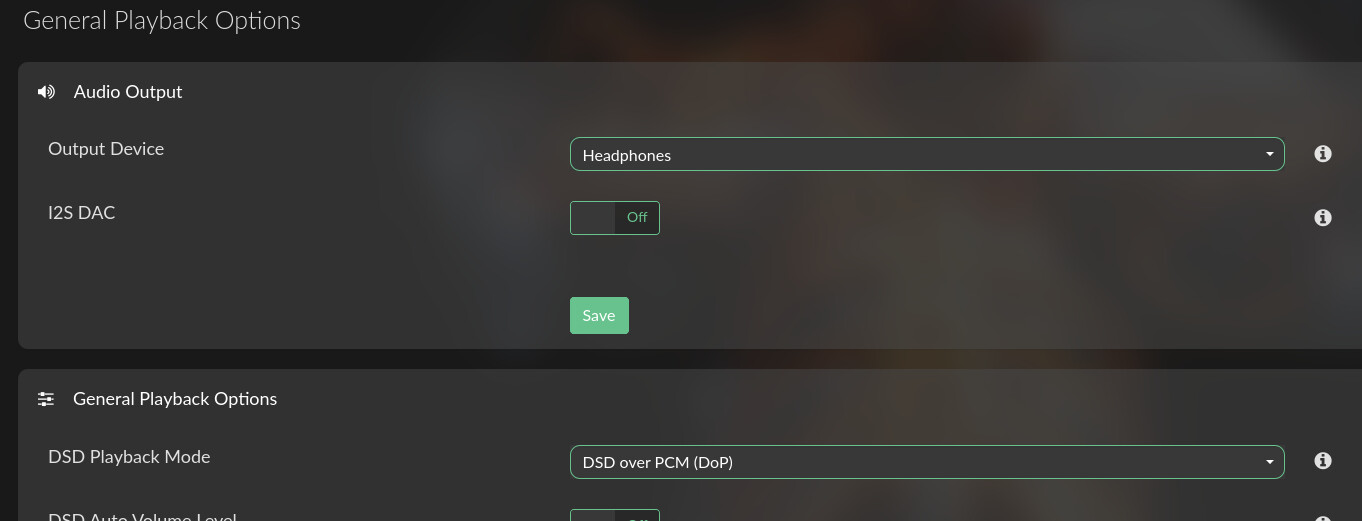

Very clear! Thanks. I should then use the frequency conversion of Volumio before attacking Camilla when I want to use DSD files?
Nope DSD over PCM (DoP) is not working. Flux not recognised by Camilla which only output white noise.
When using re-sampling function of Volumio it works fine. See screen capture (in
, sorry)
I would love Volumio to offer a selective use of this PCM resampling only for DSD flux and keep existing PCM untouched (or a selector to choose on which kind of files it applies.

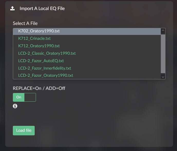

You want a list with just your Headphone EQās rightā¦?
Try using the Import Local EQ File option.
mine looks like this
Tap on the one you want then āLoad fileā it will load the file up and start using it⦠Simple ![]()
I use the PEQ so next is related to thatā¦
You can download any file, that AutoEQ uses from HERE
Select the headphone, then the *******ParametricEQ.txt then the download raw file option.(Button to th right)
You will need to rename the file with out spaces.
Next copy all EQ files to /data/INTERNAL/FusionDsp/peq on your Volumio box.
Thats it, bit of a mess about, and probaly not as convenient as lots of available presets but works well enough and beats scrolling through that massive list in the AutoEQ section.

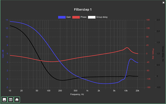

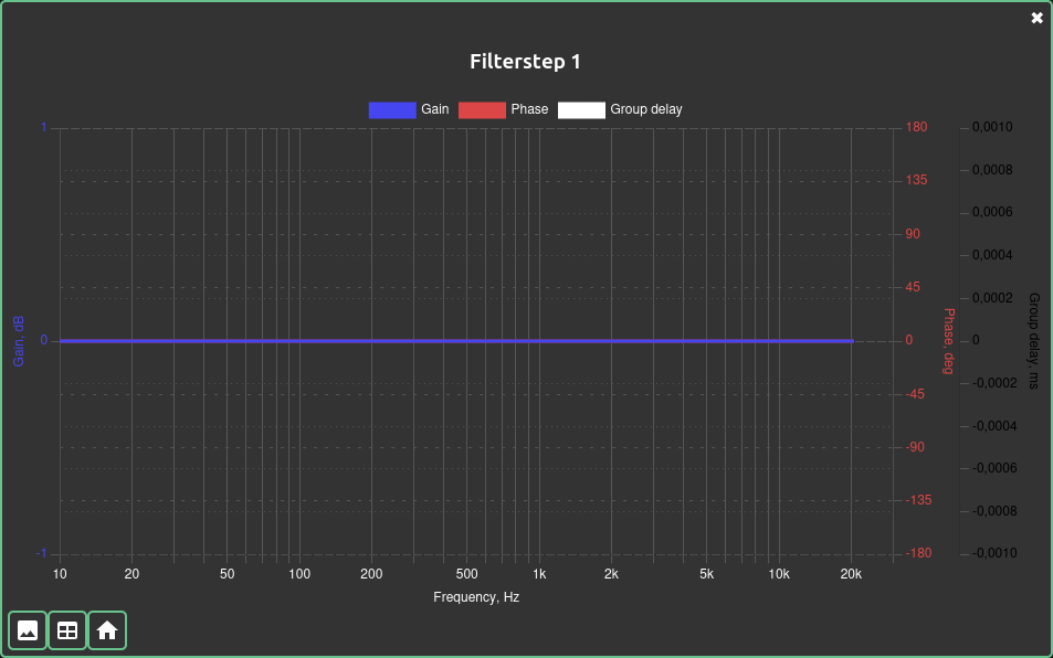

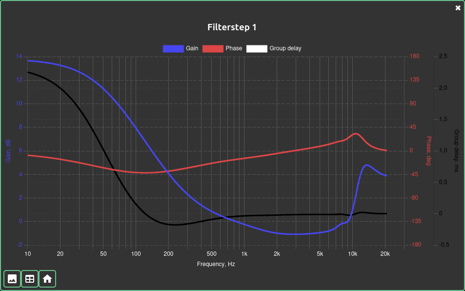

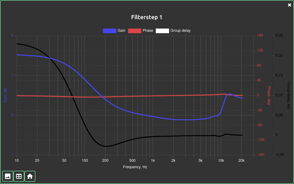

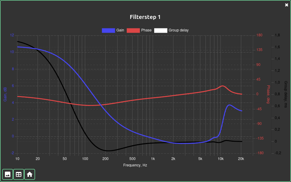

I just want to make sure youāve noticed how volume works in FusionDsp.
The parameters are adjusted according to the volume level. Itās not just a translated curve, but the coefficients change. Take a close look at the blue curve in the following screenshots and the scale on the left-hand side.
Threshold setting: 50
loudness curves
volume level : 10
volume level : 30
volume level : 47
volume level : >50
Yes. Unless Iām missing something, I fully understand what you are saying and what these graphs are showing.
The LoudnessGain coefficient changes through linear interpolation. The frequencies and Q-value of the filter remain unchanged.
This is also what Iāve used in my calculations, and tried to reflect in my github issue. I may well have been unclear about this in my attempts at an explanation.
Does this clarify things?
