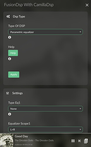

Is there a way to adjust 4 settings and select those settings in the menu on the phone.
Not to have adjust each time in the the settings of the plugin.
like preset?
please have a look at online help in FusionDsp.
