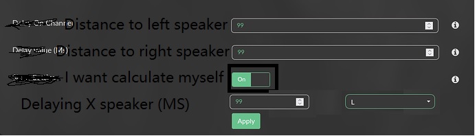

I’ve got an improvement idea which would make this very easy to use setting for most end user.
How about if there would be input field for left and right speakers? We’re you input the distance to each speaker.
The plugin could calculate rest.
For more advanced user who can calculate it themselves there could still be this delay settings as it is, so it’s way easier to fine tune if needed.
Something like that (See the mad paint skills :))
And ideally the automatica calculated values would be automatically in the delay field, if i want to fine tune with the correct channel selected.

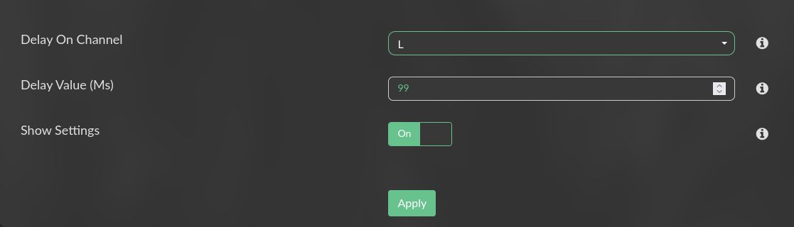

Thanks! However, I can’t seem to find the delay setting.
Uppdated the plug in, uninstalled and installed again, but can’t seem to find it.
Running this on both RPi 2B+ and RPi 3A.
Checked both in Android app and direct browser connection to the IP of the RPi.
What am I missing?
Thanks,
/Erik
You need FusionDsp v0.1.16. Please reboot after install

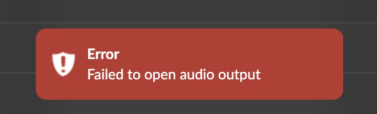

Hi, I just upgraded from 0.1.14 to 0.1.16 and I get the error below, even after multiple restarts. Disabling the plug-in fixes the issue.
Do you use a crossfeed?
No crossfeed
Log: http://logs.volumio.org/volumio/EwT4f5V.html
did you reboot after install?
yes, twice
did you set a delay?
