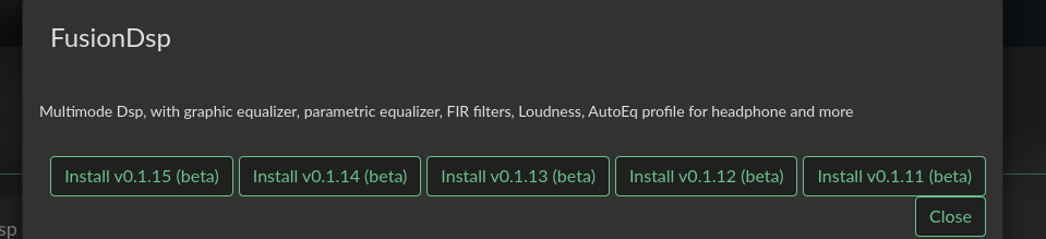

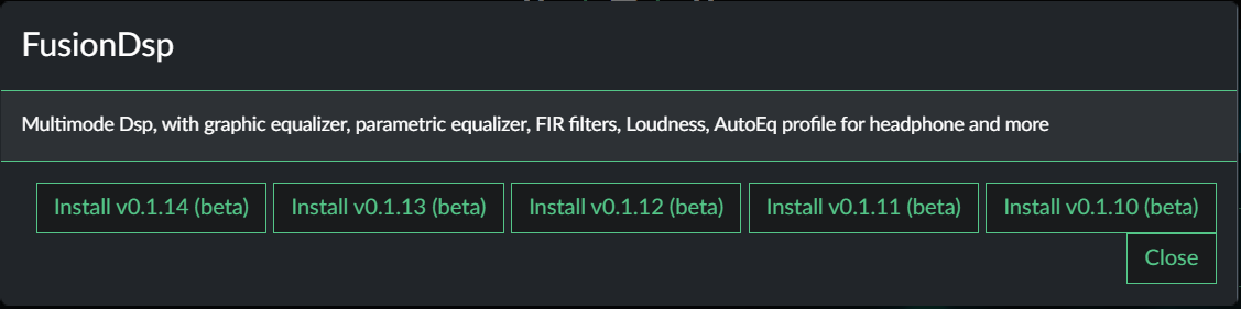

Wow! That was fast. I will check as soon v0.1.15 is available in the Plugin Manager. Thanks!
IT is :wink:
Can“t see it :slightly_frowning_face:. Do I have to update the view? If yes, how to do that?

Sorry, my bad I forgot a step… Should be ok now
