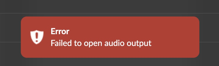

No delay set. Just parametric EQ and loudness (which was working fine in 0.1.14)
Is it possible for you to ssh and send the file
/data/configuration/audio_interface/fusiondsp/camilladsp.yml
Sorry, not sure of the best way to send it. Hope this is ok:

It seems you updated the plugin? Right?
Can you remove it, reboot and reinstall?
Yes I updated the plugin because I wanted to preserve my settings/presets.
Now I have removed it, rebooted and reinstalled 0.1.16 and it is working. However I lost all settings and presets in the process so I had to rebuild those.
I’m sorry for that. But in v0.1.16 I added parameters used for delay. As they didn’t exist in previous version, it cause the problem…
I hope you had a backup for your values … Or it seems from autoeq?
No need to apologize - I am just sharing issues to try to help improve the beta :blush: :+1:t2:
Enjoy your Sunday!
Sorry, the idea of a reboot should have occurred to me.
after reboot I could setup delay parameters, worked well with my music library and tidal connect.

Please, send log using : Sending logs for troubleshooting - Volumio Documentation after a reboot and use Spotify
and send
Edit: I found something wrong in log. I fixed it. But I can’t push a new version today.
It fix some problem with delay, but not sure for Spotify connect…

When have the message from your screenshot?

Thanks. I see a problem, but not linked to Spotify connect. It is fix for me. The workaround is to set a filter on right channel, with no effect, or use graphic Eq mode.
