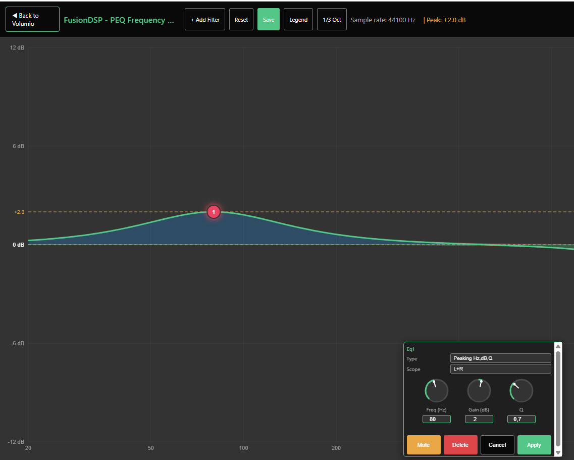

If I try to open the graphical thingy via a browser, it opens on local host.
If i manual enter the correct ip on port 10015, using the back to volumio button it get stuck again on ip 127.0.0.1.
But great addition this graphical interface. I like it.
Yes it may happen when you update the plugin.
Disable the plugin, reboot and reenable it.

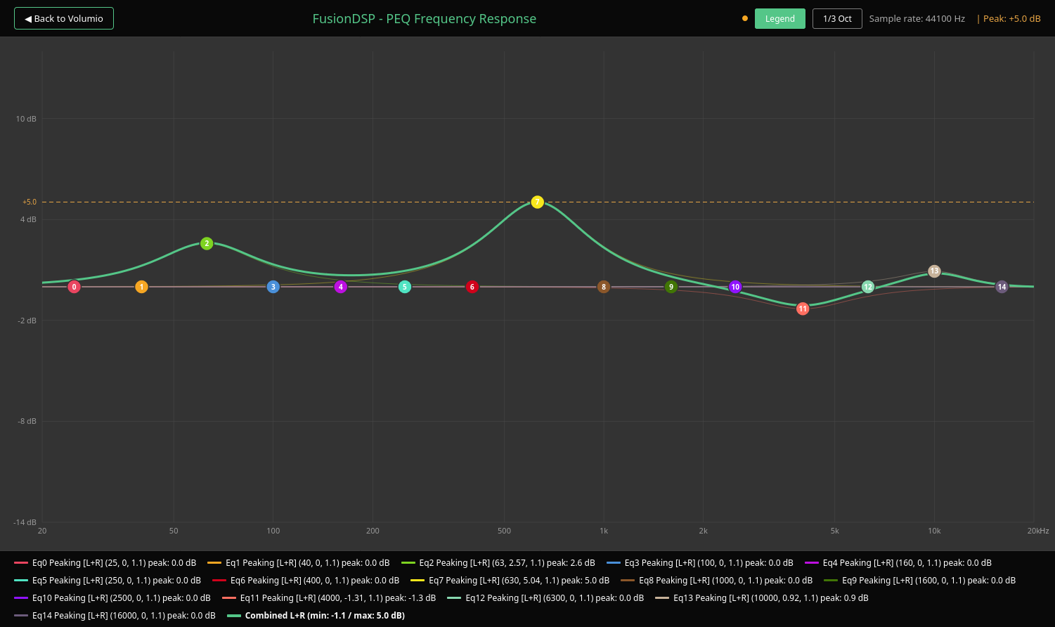

Hi, ive a a question about highshelf slope db octaaf. The graph show an effect, but it is unhearable. Even extreme filters. My target is slowly lower te curve from 300hz till the highest freq by 2db pro octaaf. How to do that. Is there a bug in this filter??
Thank by advance!
Does this occur when you put the same value in text mode in the plugin? You can check if the curve is the same.

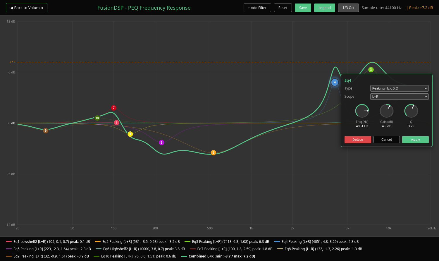

FusionDsp stable v3.0.2
Based on Camilladsp 4.1.3!
-improved graphical Eq display (+ on mobile display)
  • miscellaneous code fixes
  • updated doc
Enjoy the music! :wink:

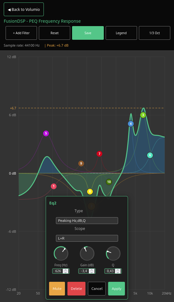

FusionDsp v3.0.3?

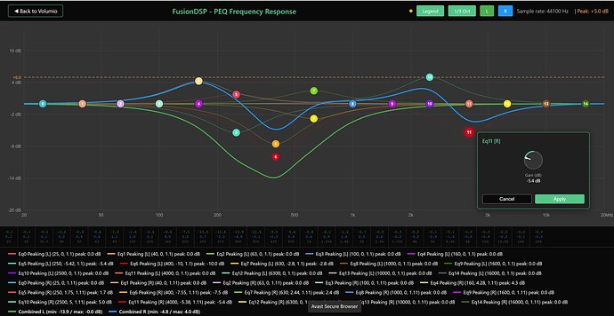

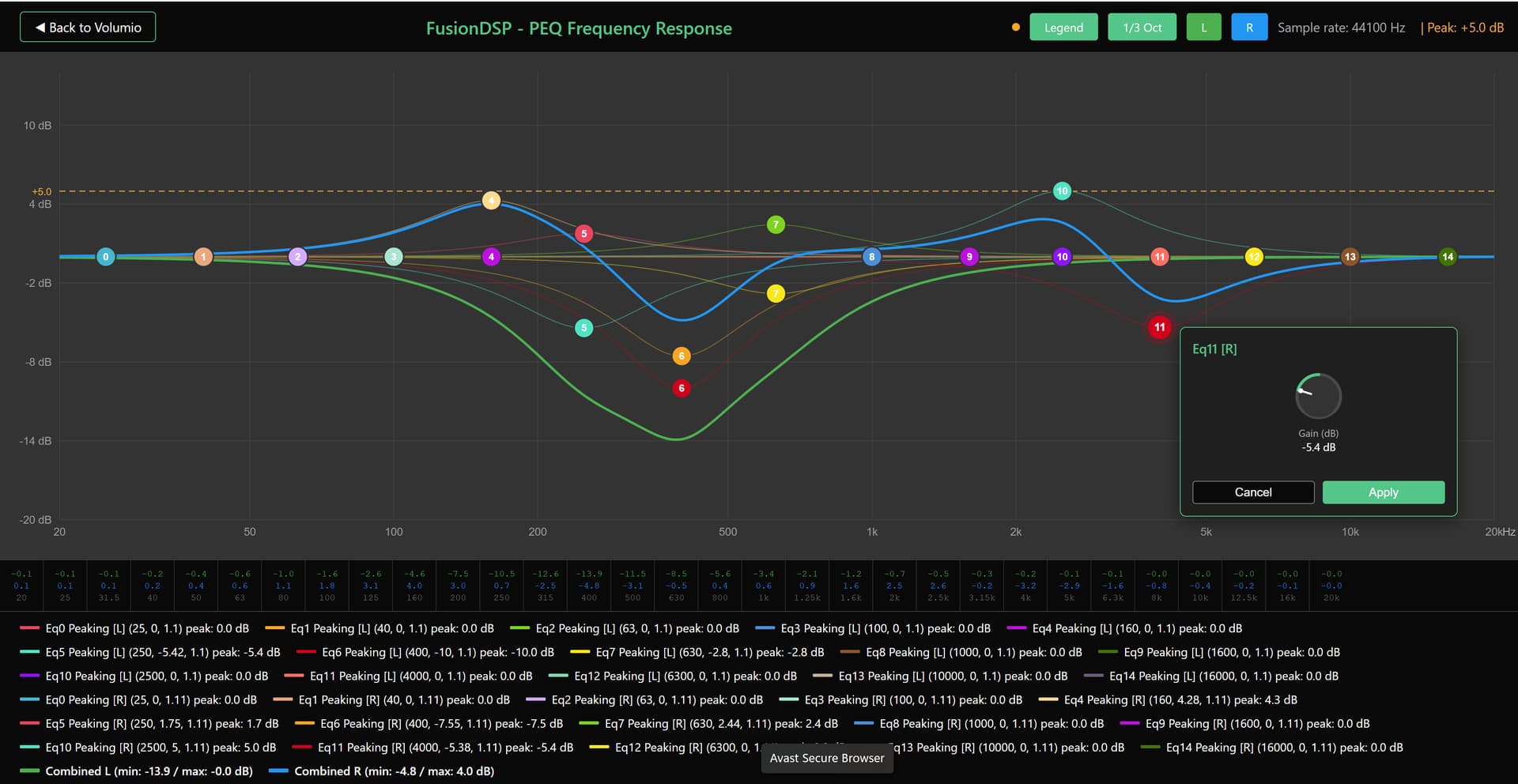

What is the screen resolution?
It is not supposed to be near the point…
volumio@motivo:~$ sudo xrandr
[sudo] password for volumio:
Screen 0: minimum 320 x 200, current 1280 x 800, maximum 7680 x 7680
HDMI-1 disconnected primary (normal left inverted right x axis y axis)
HDMI-2 disconnected (normal left inverted right x axis y axis)
DSI-1 connected 1280x800+0+0 left (normal left inverted right x axis y axis) 0mm x 0mm
   800x1280      60.00*+
(PS are we hijacking this post?)
:slightly_smiling_face:‍:arrow_up_down: Yes sorry…

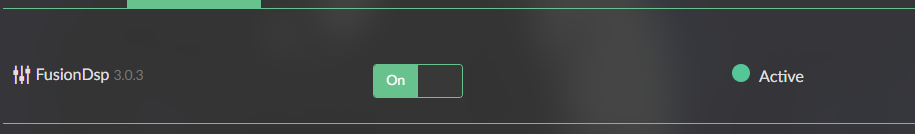

Comment?
Seems you don’t use FusionDsp beta 3.0.3
:upside_down_face: :crazy_face:
oe elle the arrows?
web browser issue?
no clue tried with:
Edge
Chrome
Firefox
Chromium Kiosk on motivo.
Firefox/ubuntu ok…
Volumio app android nok…
I’ll have a look
