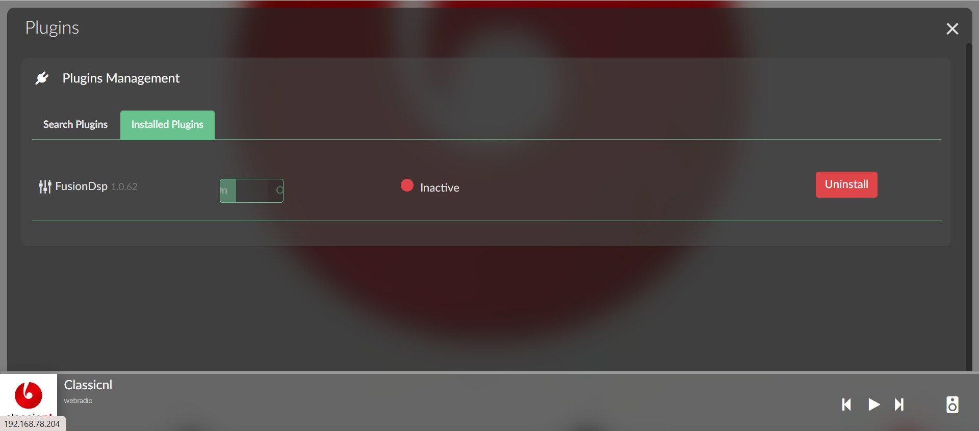

Now all and everything is setup, running and not giving so much problems, till I try to update the FusionDSP plugin and in went slow, in the end it removed the plugin itself and now everything is running as it should

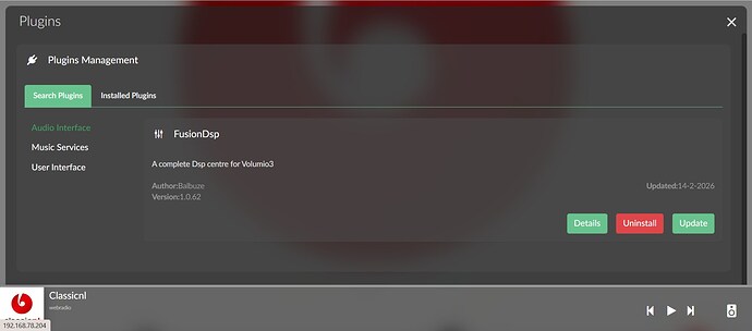

Is the update button always visible, even when there is no update?
Can you see which version of FusionDSP is running and which version is available?

When you install FusionDsp, it’s by default the last version available. You can see an update, but this for the next Volumio 4 , not yet deployed on volumio hardware… So no need for update.

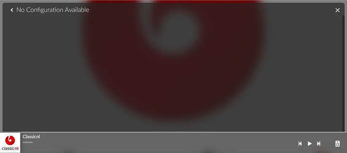

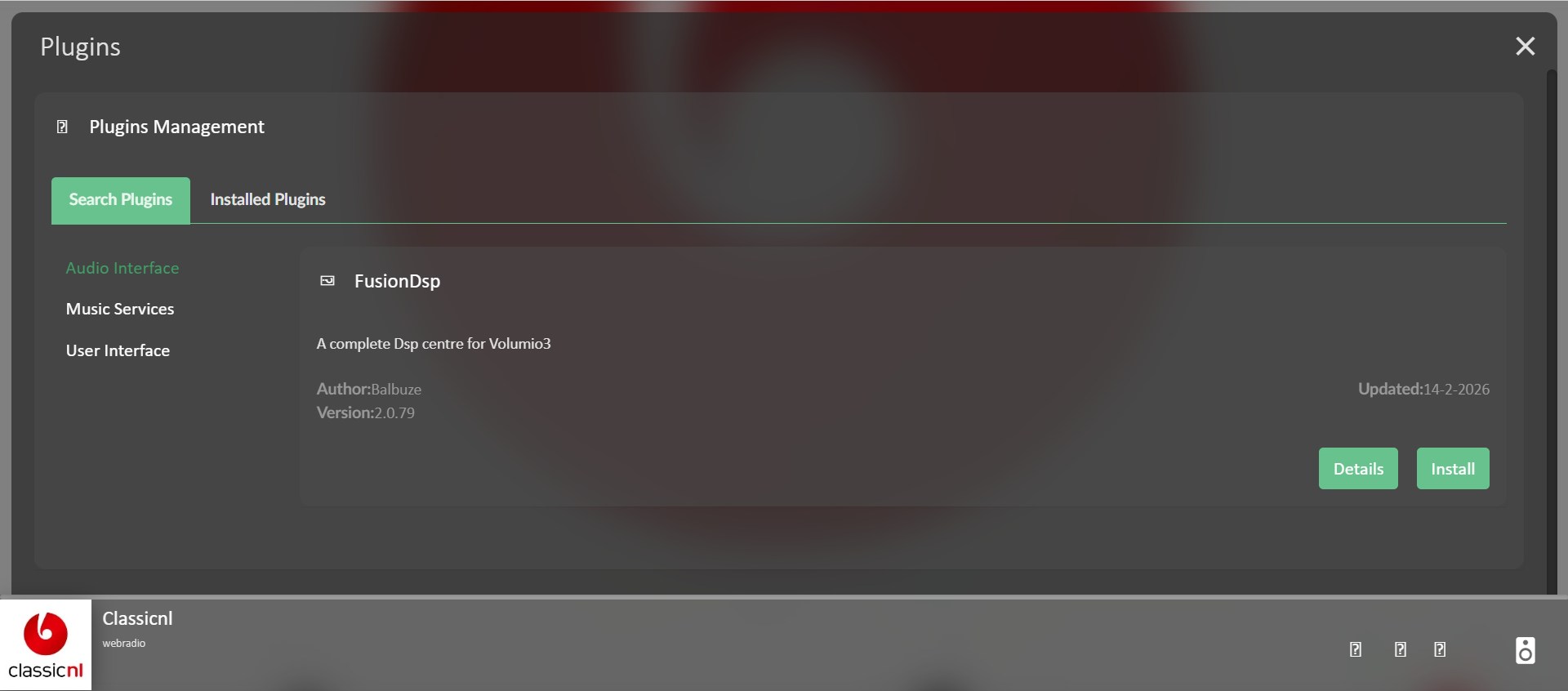

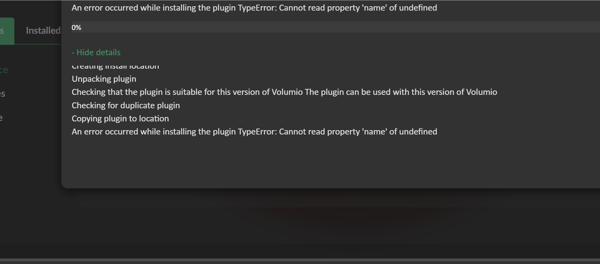

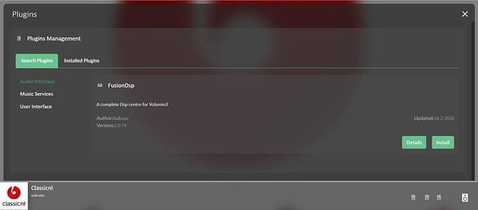

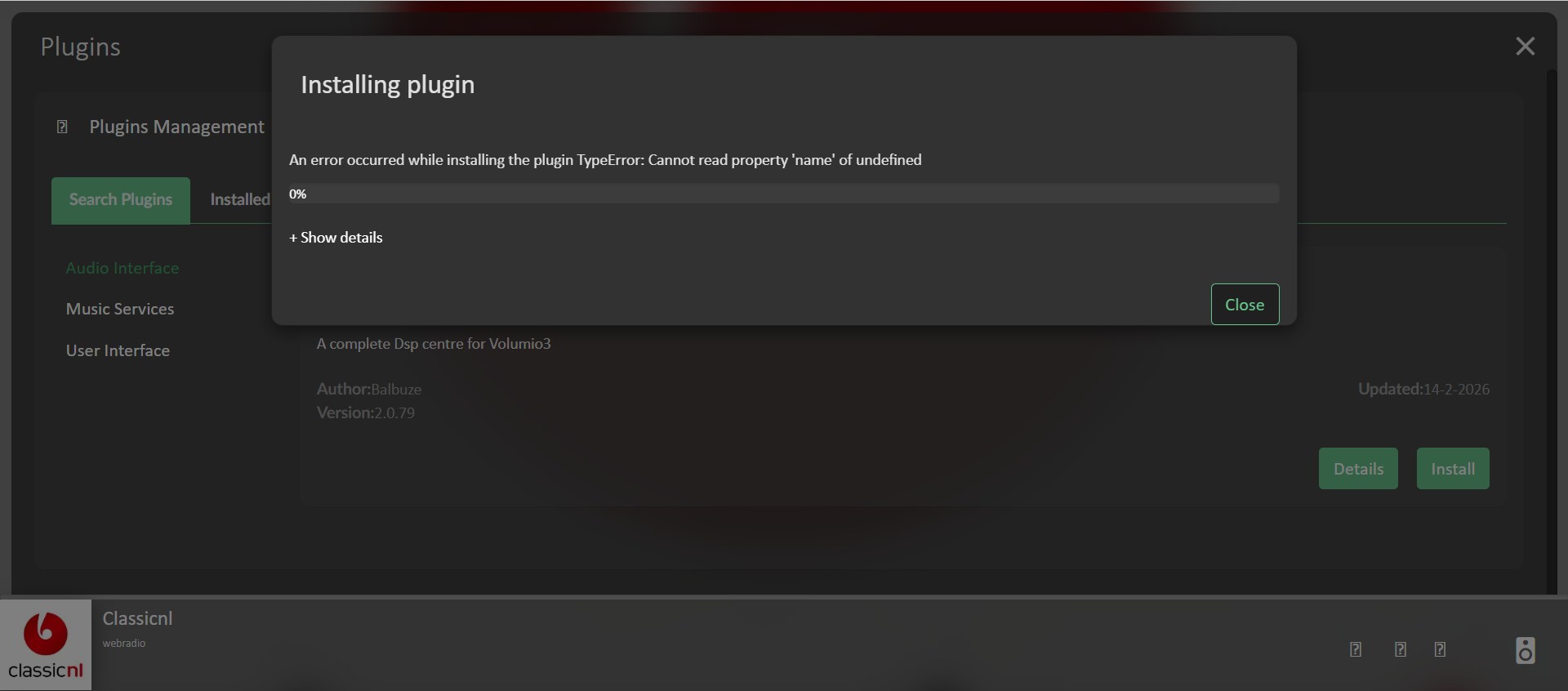

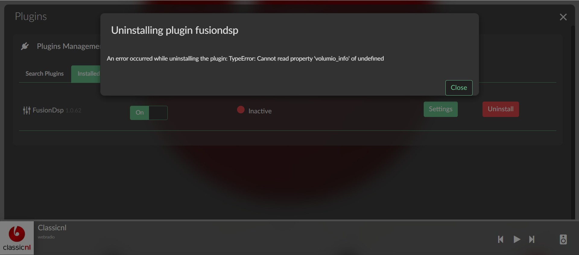

Unable to reinstall te FusioDSP plugin after the auto removal
edit http://logs.volumio.org/rivoplus/RA9MnS9.html
log after trying to reinstall
edit and when I again give a look
something happend
but
http://logs.volumio.org/rivoplus/CivyBtV.html
edit 2
uninstalling is also not possible
