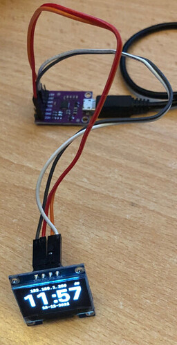

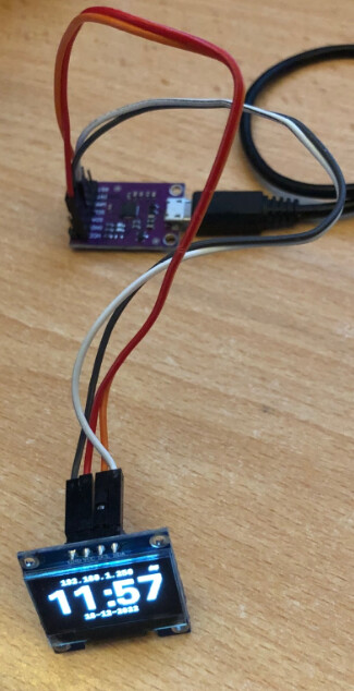

And working, However not usable for displaying CAVA as the framerate is way to low.
Great! Good result!
Glad you managed to solve the issue @Wheaten Shame it’s so slow
Yeah but to slow for CAVA. Max -f 15 and it seems like the bars are glued to the screen
