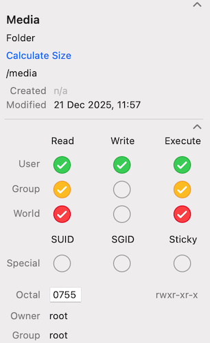

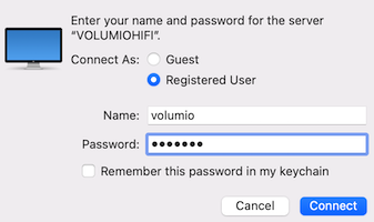

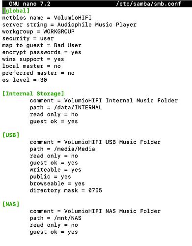

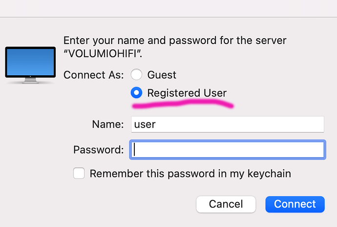

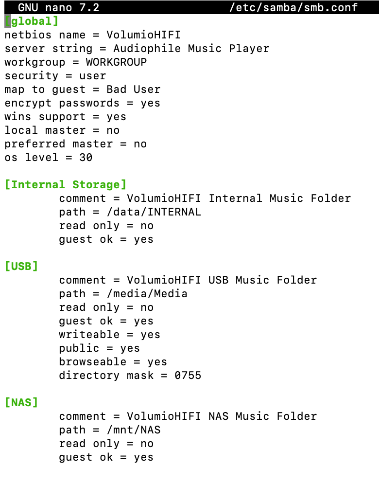

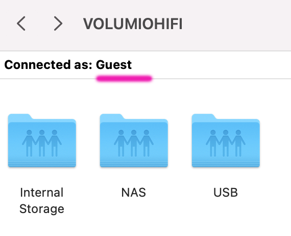

I connected a USB drive. exАat. Drive has a Media folder. If I connect as a Guest, I can’t delete or add files to the drive. I can’t connect as a registered user. I tried volume:volume, VolumeHIFI:volumio, root:root, root:volumio. It won’t let me in. Media folder is root-root 755. MacOS by Finder. smb://192.168.1.101/media/Media What I do wrong?

Username volumio
Password volumio
The only combination you have not listed as attempted so far.
I make a mistake - not volume:volume but volumio:volumio - do not work. Sorry long day.

In the first post I wrote: “If I connect as a Guest, I can’t delete or add files to the drive.”
So no, I can’t.
