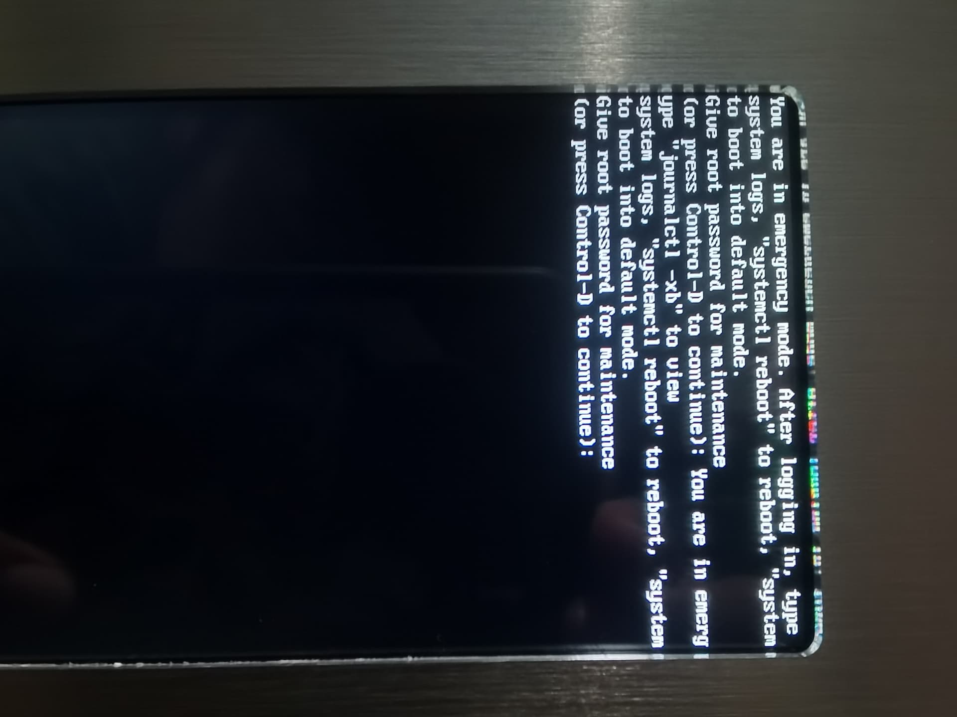

I am trying to install Volumio 3 onto the Lexar 2TB MicroSDXC card in my Holo Audio Red transport. I am using the Raspberry PI Imager to format the card and copy across the .img
Everything works fine if I use a smaller MicroSD card than the 2TB card, but the Holo Audio Red fails to start properly if I use the 2TB card, I get the dreaded “welcome to emergency mode”.
Looking at the journalctl -xb error messages, it seems that the mmcblk0p3 partition is not mounting correctly.
I have tried the same 2TB MicroSDXC card in a Raspberry Pi 4B, with the same emergency mode. I have used the Raspberry Pi Imager to install 64 bit Raspberry Pi OS on the 2TB card, and everything is fine, runs perfectly, no emergency mode, so I know the 2TB card is fine…
I wonder if 2TB MicroSDXC cards are an edge case that Volumio haven’t tested…
Any ideas?
journal -xb error messages are:
EXT4-fs (mmcblk0p3): ext4_check_descriptors: Block bitmap for group 131056 not in group (block 35184857724488)!
EXT4-fs (mmcblk0p3): group descriptors corrupted!

Hi nerd! Same issue with boot up with ssd nvme drive.
After a clean flashed using balenca etcher and booting up again same goes happen in my display showing emergency mode.
Do i need to do the instruction above?
Hardware : rpi 5 and nvme ssd m.2 drive/hat
Os version : volumio 3.832
