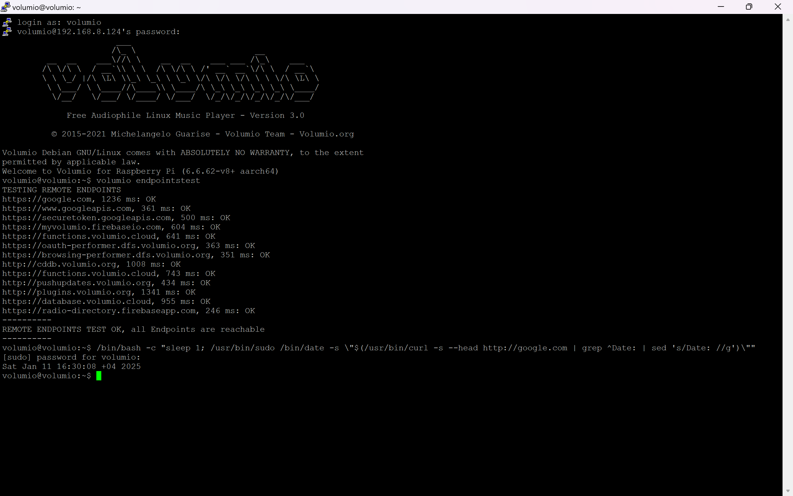

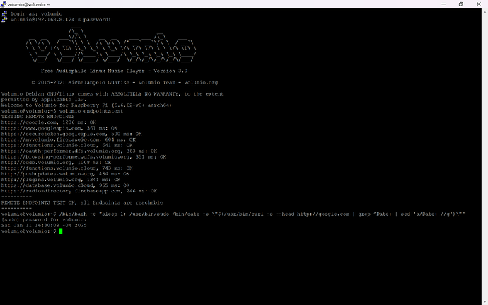

  • Wrong date on the rPi. Latency in netwrok response to set the corrrect date time. Run the command date. If the date/time is off by 2+ hours run: /bin/bash -c "sleep 1; /usr/bin/sudo /bin/date -s \"$(/usr/bin/curl -s --head http://google.com | grep ^Date: | sed 's/Date: //g')\"" and see if this solves your problem.
  • Double account issues. Same device, same device name. Log out from my volumio, reboot and log in again.

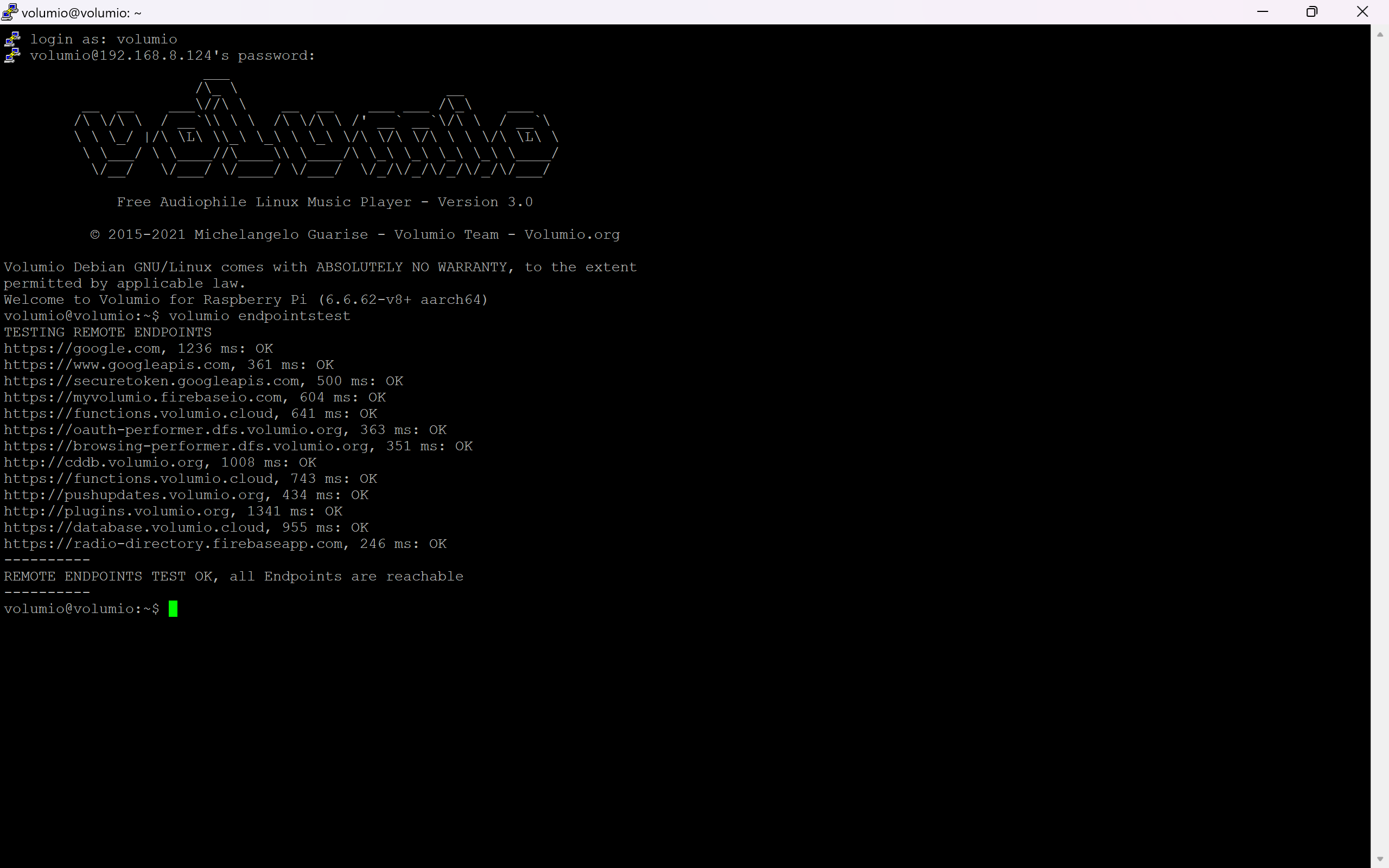

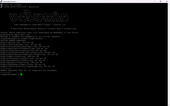

Endpointstest;
Time and date is correct:
http://logs.volumio.org/volumio/0M9pcA1.html
I followed all your instructions but still no plugins showing.
@Darmur, @DED
Can you have a look at bullit 3, Can’t find any reason for it in the log. (network and speed seems more than adequate)
