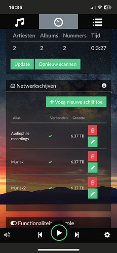

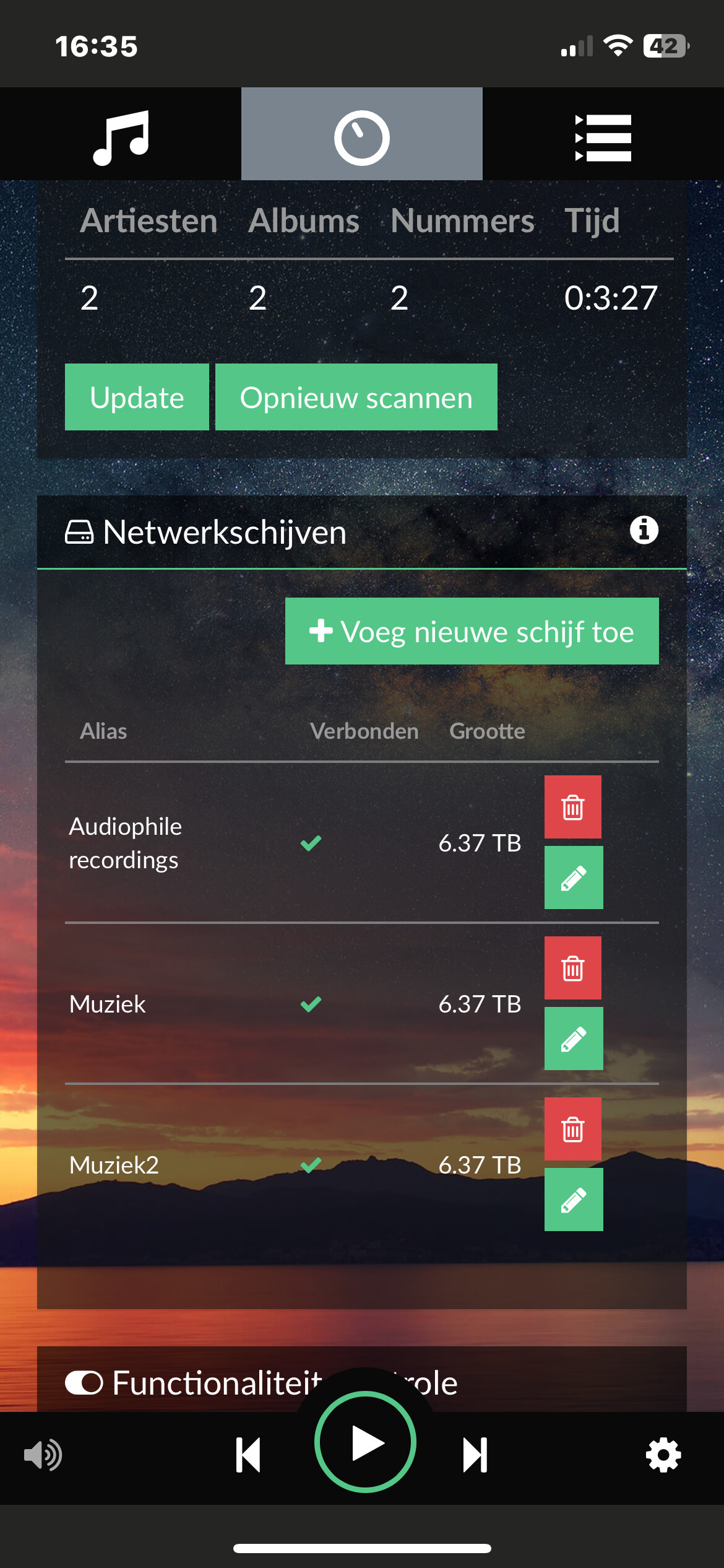

It’s in Dutch; sorry. You see the maps ‘audiophile recordings, Muziek and Muziek2 are NAS maps mounted ok. The maps contain flac file wich are checked and ok (i can play them with Flacbox). Wy does Volumio import them in my music library?
Because a mount is successful it doesn’t mean that the files are accessible. If you copy or manage files using a windows box, the rights go wrong. If the rights are not granted for the user that mapped the drive it can’t be scanned or accessed.
