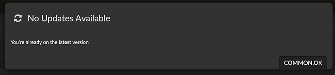

Nvrmnd, see it on the downloads page and am flashing it to the SD card now. Not sure if it’s not the latest version why the system doesn’t know there’s a new version out though.
