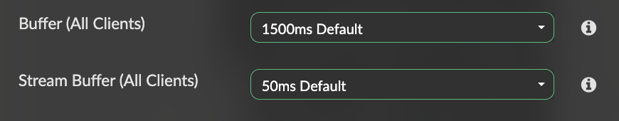

Enabling multiroom playback in Volumio works for me to address your first issue. There are other threads on this.
Thanks, enabling Multiroom Playback fixed both of my issues! A few weeks ago, I had gone through the Volumio settings and turned off features I don’t use, and Multiroom was one of them. I didn’t play Qobuz Connect until days later, and I didn’t associate that changing a setting was related to the issues.
I see that the settings for Multiroom has a couple of values relating to delay buffer.
My conjecture is that the interface to Qobuz Connect operates with a bit of delay, and the Multiroom option just happens to add enough delay to make it work properly.
The Multiroom setting is a workaround, but the bug remains open and should be fixed, and I won’t mark this as a solution yet.
