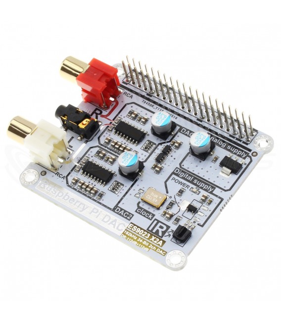

Ess 9023 does not provide HW volume mixer.

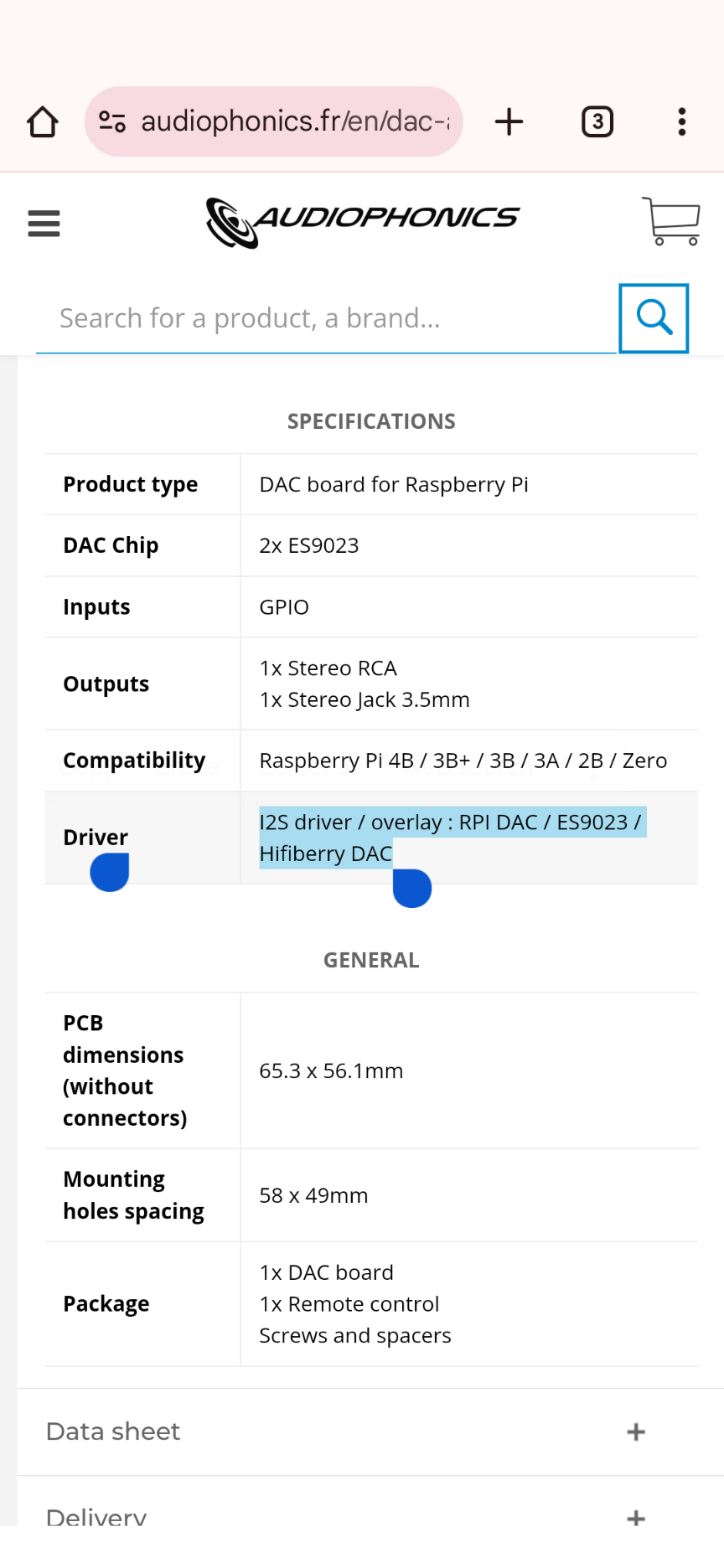

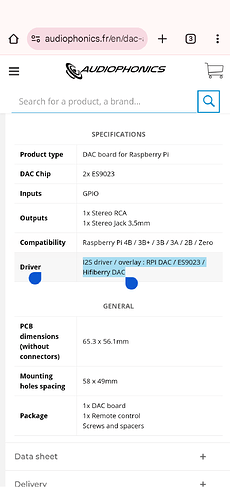

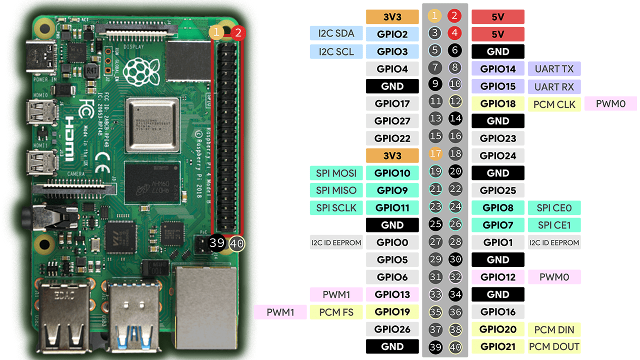

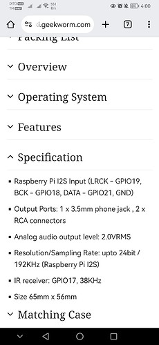

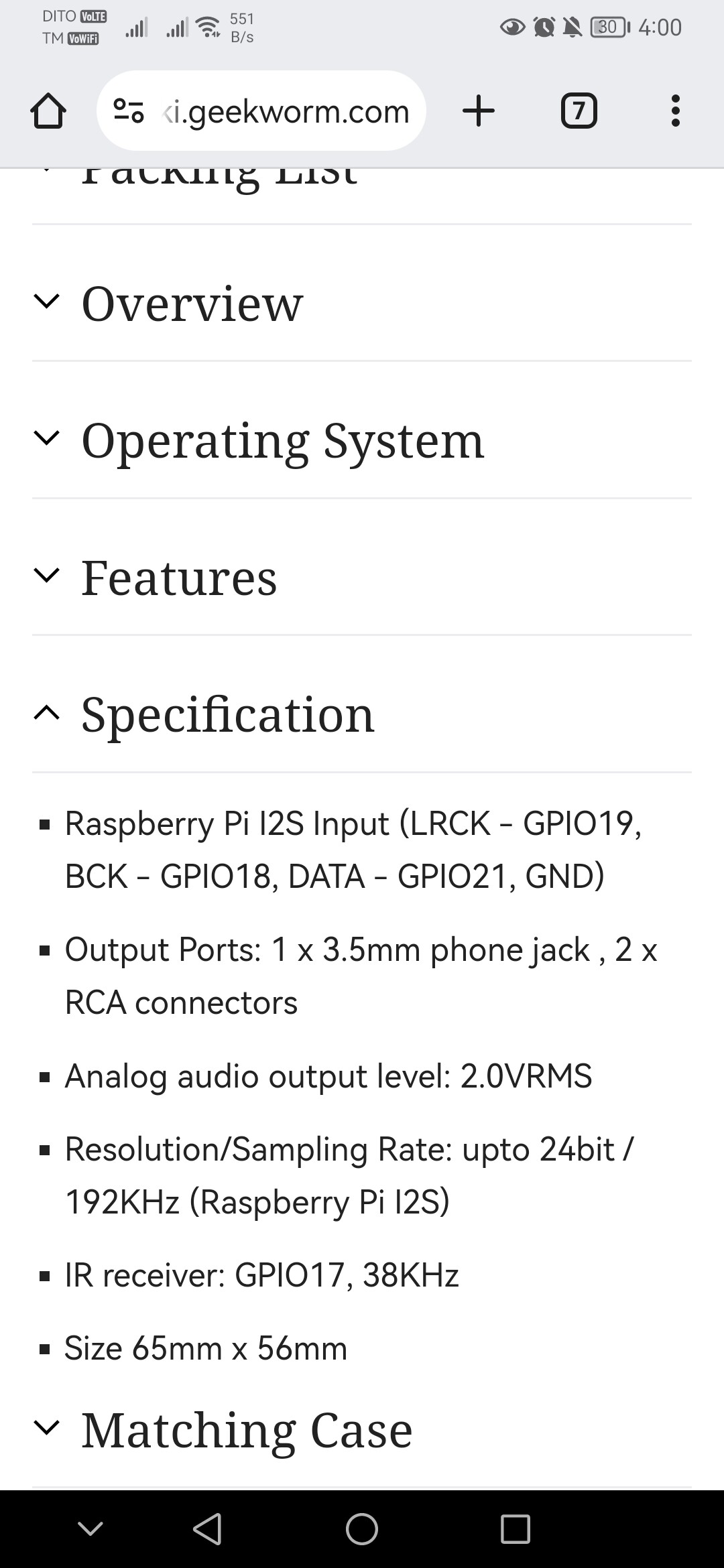

Hi michel! I am planning to buy this, dac would you mind me to know what gpio pinout is used. I am planning to seperate the power of this dac from rpi.
