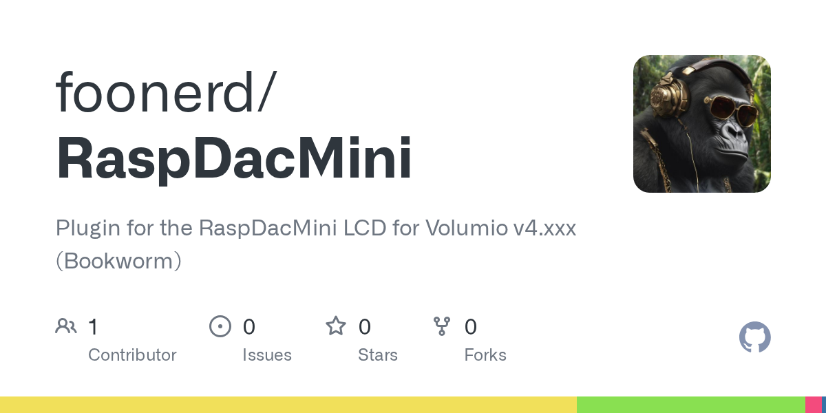

Audiophonics RaspDacMini LCD Plugin for Volumio 4
A Volumio 4 (Bookworm) plugin for the Audiophonics RaspDacMini LCD display is now available.
The plugin provides real-time playback display with album art, scrolling text, volume indicators, and configurable screen timeout.
Repository:
Thanks to @olivier_audiophonics for the compositor foundation that made this possible.
The decision on whether to submit this plugin to the official Volumio plugin store or keep it as a standalone installation is still being considered. Community feedback is welcome and may influence this decision.
Feedback and testing welcome.
