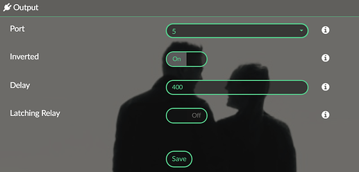

Could you share your logs and config? The delay feature was introduced to tackle exactly the play - pause - play issue you are having. So when a pause or stop command is received, it waits for the prescribed time before turning off the GPIO.
Of course, only I’m not entirely sure how to obtain the logs. I have close to no experience with Pi’s or the underlying OS.
The config:
The output is inverted, as the hardware behaved opposite of my intentions. I have the GPIO trigger a 5V relay through a logic level converter. Maybe it’s the inversion that’s the problem?
Well, I have a simple test – set a 0 delay, and check if the amp comes on when you hit Play, and goes off when you hit Pause - then the outputs are configured correctly ![]()
If your on a relatively new version of Volumio, head over to the ip.address/dev page and enable the live log. Then on a new page, start a webradio and change stream. You should see some line such as [ASDebug] InitTimeout - Amp off in...

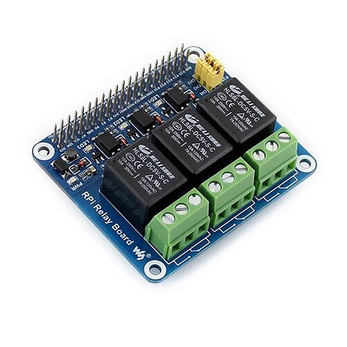

Heya Mike!
I would pick up one of these cheap relay boards of ebay/amazon.
One such example would be
These guys essentially let you switch either AC or DC loads, using the pi’s gpios via an optocoupler. So, just many words for a switch that the pi (via this plugin) can operate.
You should be able to feed 12v source to the relay, and when it closes, trigger the amp’s soft start. The plugin let’s you either set the amp to always on/off or send a pulse.
This should give you some hints, let us know if you are in into issue!
Cheers
