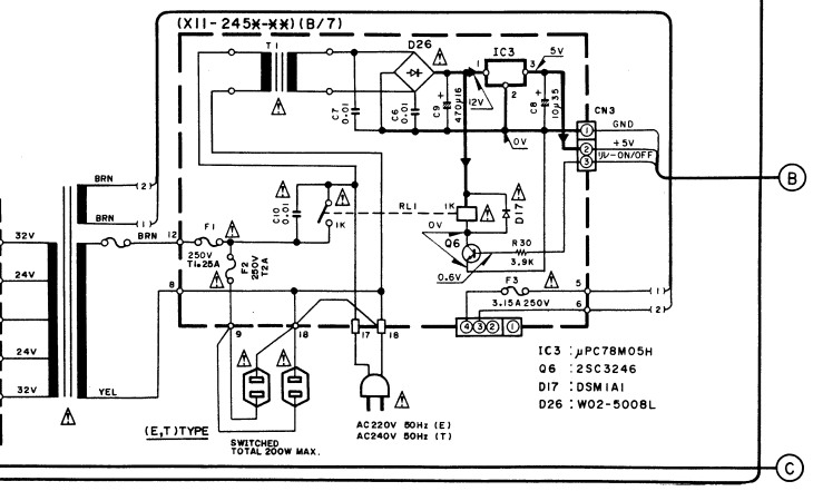

I have an old integrated amp Kenwood A-91 that I would like to be able to switch on/off from the RPi. Hence my interest in AmpSwitch.
I read in this thread:
(1) What would be the pros/cons of a transistor/mosfet vs. a relay in my case?
(2) Below is the schematic of my amp’s power supply chip. I guess the relay should hook the phase straight after the plug (i.e. point numbered 17 or 18 on the scheme), am I correct?
(3) Could the on/off cycles trigerred by AmpSwitch via a relay as per (2) - thus bypassing the standby mode of the amp I believe - add excessive wear to my amp?
(4) I read about transistor/mosfet and saw they could be used as electronical switch, which I guess is the use referred to in this thread. However I can’t get where it should be located in my “circuit” (base = signal from GPIO; collector = should it bear high voltage? emitter = ?).
Any help would be much appreciated.
Best,
Dtog
