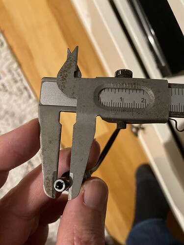

Hi
Additionnal question: do you have a power supply for the Kali connection (see datas in the pictures, for jack connector mainly. Volt & Amp are the usual)
This to adjust weight/size.
Info like adress will be by PM.
