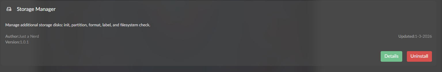

The repair requires an e2fsck followed by a resize2fs against sda3. I have a Storage Manager plugin in beta that includes filesystem check/repair and resize functions and handles large disks correctly. It would be worth trying as an alternative to the manual SSH repair steps.
Install it from the plugin store - look for Storage Manager. Once installed, run the filesystem check/repair function first, then the resize. Let us know what the plugin reports - this will be a useful field test on the x86 path.

When i use Storage manager, I cannot select any drive and when i click data partition resize, it shows 292MB free and says partition already ay full size.

Yes, that won’t work as the partition /dev/nvme0n1p3 is busy as part of Volumio’s overlay filesystem with the read-only squash file.
You can’t do this in a running system.
Boot Volumio from a usb stick and then try again, that should work.
Should i boot a fresh copy?
