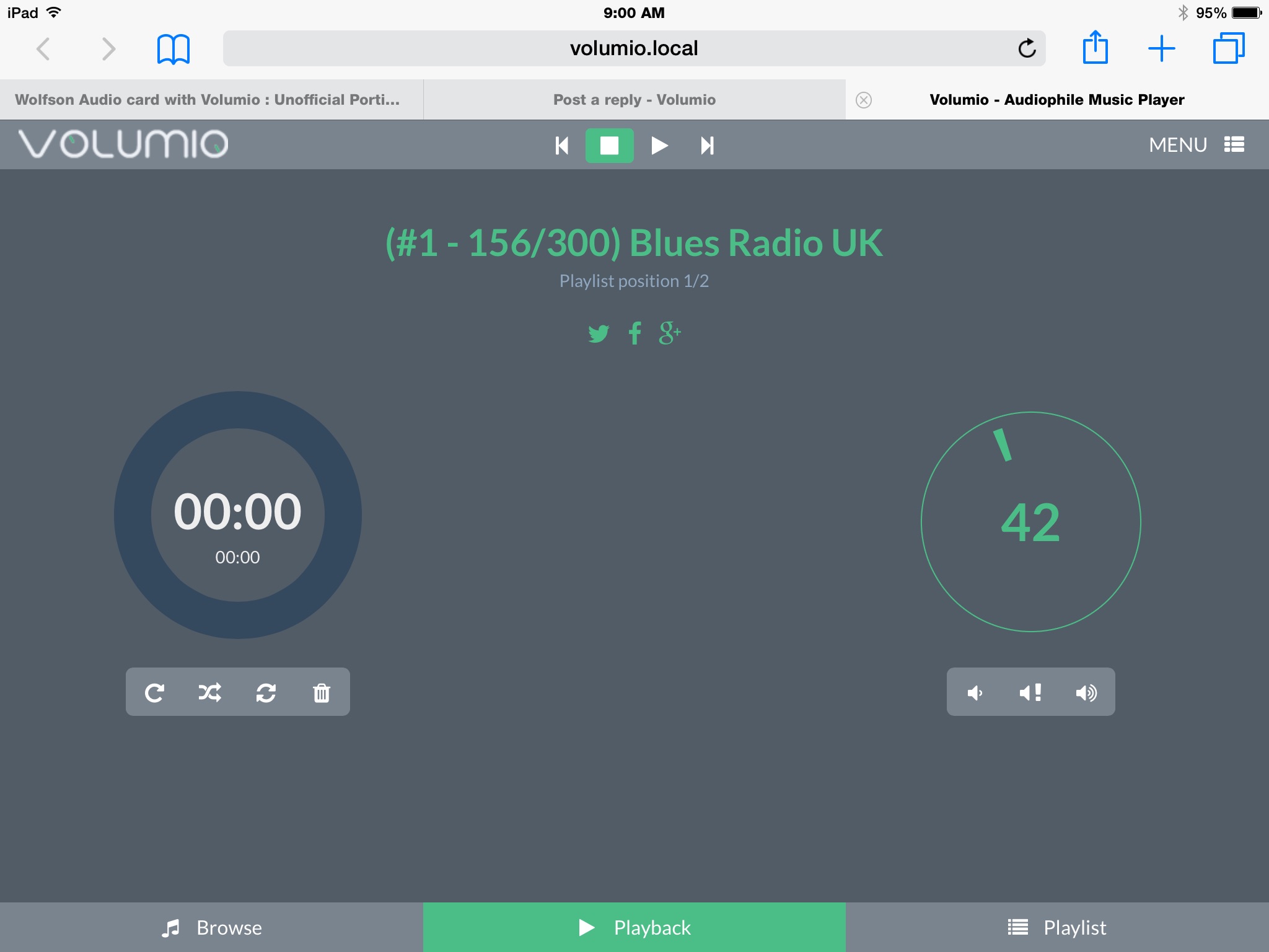

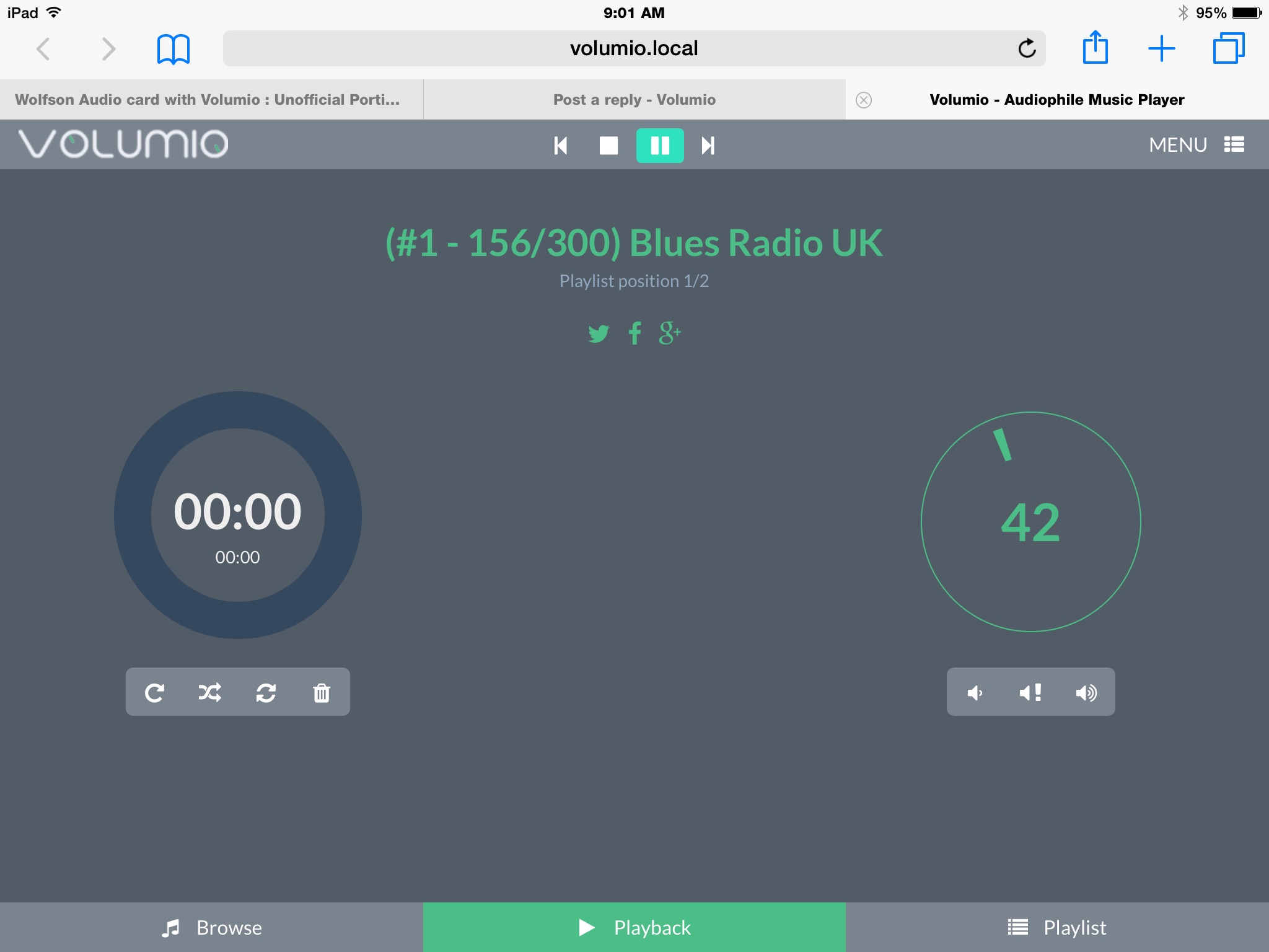

image.jpgWhen I load a radio station the song will show but not play it
Here are two screen shots showing before and after hitting play.
I flashed the 1.4 image - set it up for software mixer. It will play the song but I get no sound from headphones or line out.
