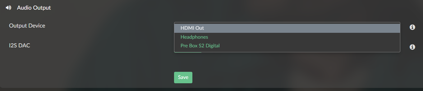

I expect with “Project pre box s2” you mean the “Project pre box s2 Digital”?
If so, the DAC should show up under Playback Options, with i2s off, as output device in the dropdown.
Thank You!!!
