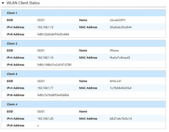

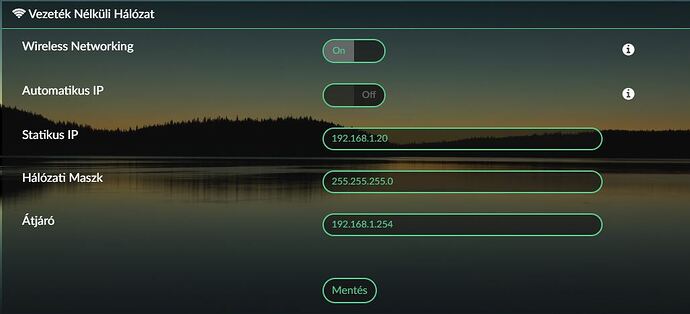

iPhone with wifi:
IP adress: 192.168.1.16 gw: 192.168.1.254 sn mask: 255.255.255.0
PC with LAN cable:
IP adress: 192.168.1.91 gw: 192.168.1.254 sn maks: 255.255.255.0
volumio with wifi:
IP adress: 192.168.1.15 gw: 192.168.1.254 sn mask: 255.255.255.0
in router settings page the volumio dont has a ipv6 adress
So all the devices are on the same network, all have correct configurations.
I can’t understand why it isn’t working for you.
Some routers will isolate all wifi clients from each other by default and many have this feature but not enabled by default, you should consult the manual of your router or try to find the setting from the configuration page of the router.
