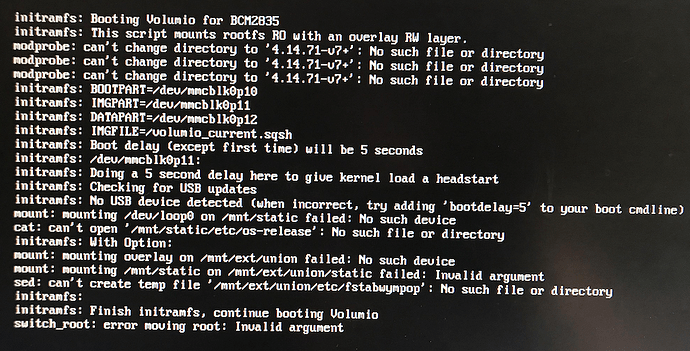

I installed Volumio through PIMM, but after the update it can no longer boot :frowning:
Current PIMM image is version 2.457 while OTA tried to update it to 2.522. I only changed IP address to fixed one.
Shoudl I have done something before running OTA?
List of errors after reboot:
