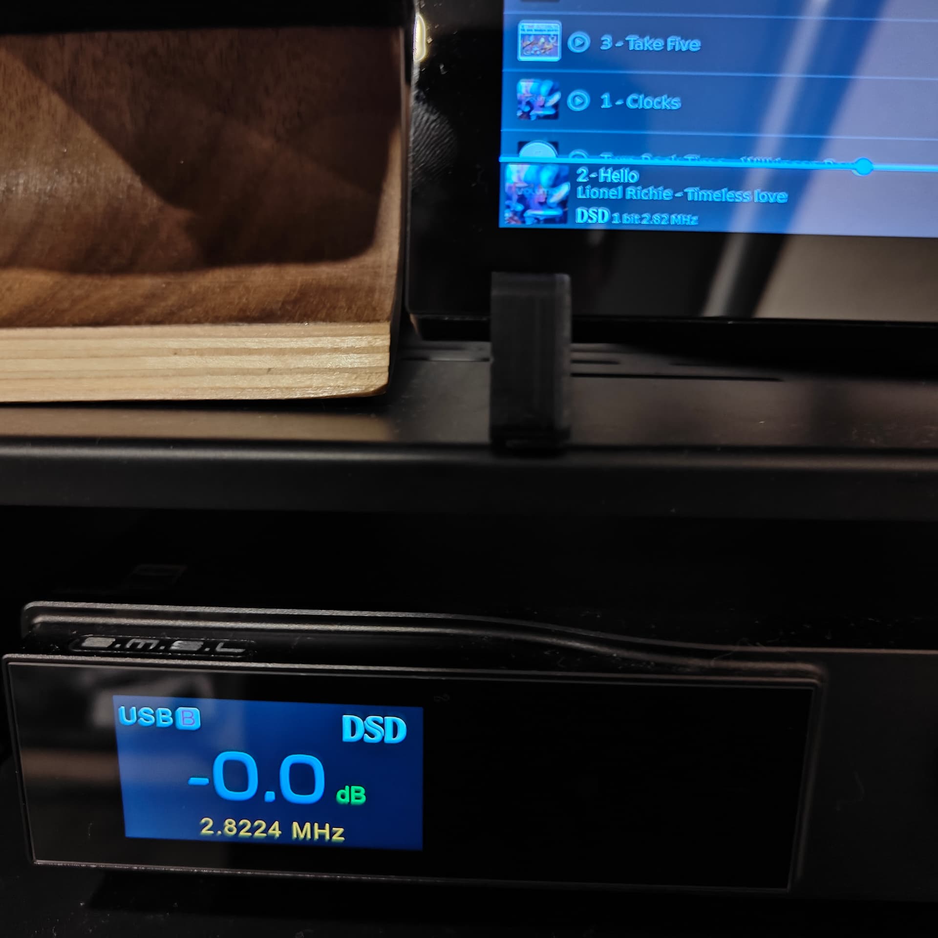

My SMSL DO400 is DSD capable, and over USB, Volumio plays DSD to my DAC but it still shows as PCM on the screen. I saw another thread that other are posting the USB spec of their DAC for future updates. Is that something I should do? to get my DAC “registered” for the kernel?
by any chance, do you use software volume control, resampling or any kind of DSP (FusionDSP)?
if yes, please disable all of them and try again.
please also provide a system log, so we can check if your DAC is recognized as DSD-direct capable when connected to USB
Thank you. I’ve followed your instructions and submitted logs for both pi’s for your review.
pi4b thru USB to SMSL DO400 -
This plays thru USB, all files, including DSD shows up as PCM on the DAC. Once I turned off FusionDSP, the DAC now shows as DSD but no sound.

DSD can’t be equalized. It’s a impossible. So you have to choose between DSD or FusionDsp
I followed up down this rabbit hole a bit based on this…
pi4b thru USB - After turning off FusionDSP, the DAC showed DSD when I played a DSD file but no sound. Following the logic, I also went and turned off peppymeter basic and VOILA, I got DSD playback on USB now! Thank you. However, one of the reasons I’m using Volumio is to be able to use peppymeter for the VU meter, but I now understand, no dsp, no peppymeter for DSD over USB.

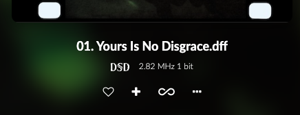

Hi @Darmur, I’m curious: I have an Innomaker Dac Pro hat with an ESS9038Q2M chip that, technically, states can do DSD native. System settings applied are as follows:
Driver: Innomaker Dac Pro
DSD Playback Mode: DSD Direct
DSD Auto Volume Level: Off
Mixer Type: Hardware
Mixer Control Name: Master
Audio Resampling: Off
This is what I see when playing .dff files:
Is this native DSD, or DSD over PCM? If it’s the latter, shouldn’t there be a flag or label indicating it as such? Thanks!
there is a conversion to PCM, because the I2S interface of the RPi does not support DSD direct
the ES9038Q2M can handle DSD direct, but it will not get it when connected to a RPi via I2S
on the Volumio UI you see the format of the file you’re playing, regardless if it is converted or not
Got it. Thanks for the confirmation!
