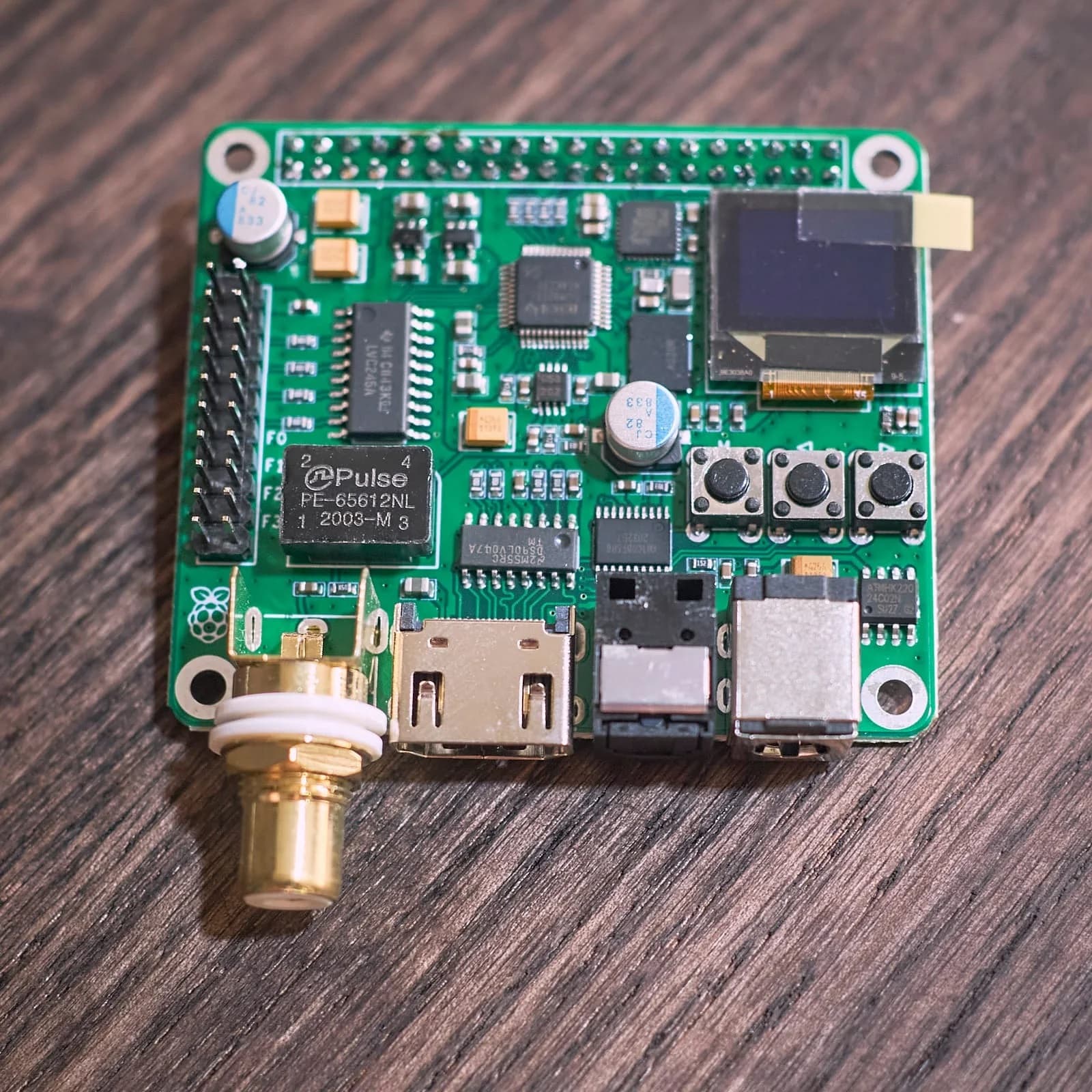

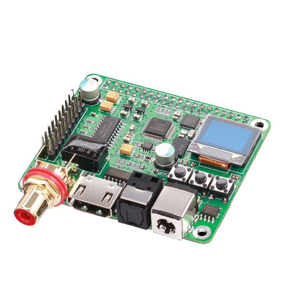

Can anyone identify this hat? Said to do native DSD but I can only get DoP /PCM . Meant to work with Volumio natively with DSD

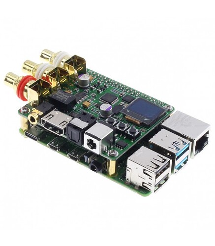

Interesting @SteveG . I don’t know what it is, but I’ve found listings for it on Amazon, AliExpress and other sites, and a similar version in Audiophonics:
Looks like it’s using a PCM5122 . No manufacturer listed. And on the Audiophonics site, they recommend using “RPI DAC” Overlay driver.
So unable to get native DSD from it then? or until someone supports it?

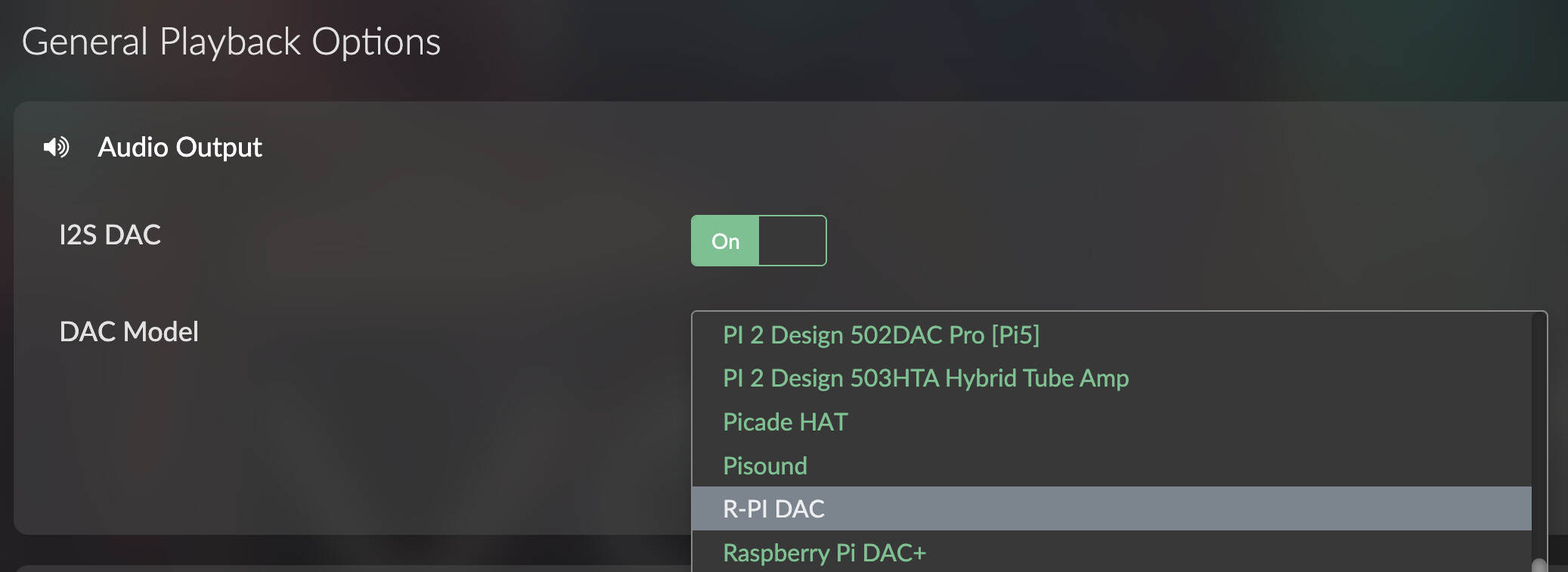

I’m super new to the Pi world. How do I add the overlay? I did select the generic I2S Hat
You select it from the drop-down menu. Here’s a screenshot:
This is what I think Audiophonics refers to on their note on their link as “To make this module work with a Raspberry Pi, you need to use the RPI DAC overlay driver (Moode Audio, Volumio, piCorePlayer, RuneAudio).”

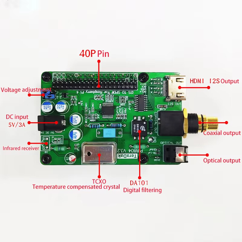

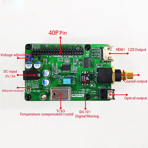

Please include this i2s hat for future updates!
I’m just wanting a streamer that can output native DSD then into a DAC not having the Pi as a DAC. I2S would be ideal.
But what other hats or what USB?
