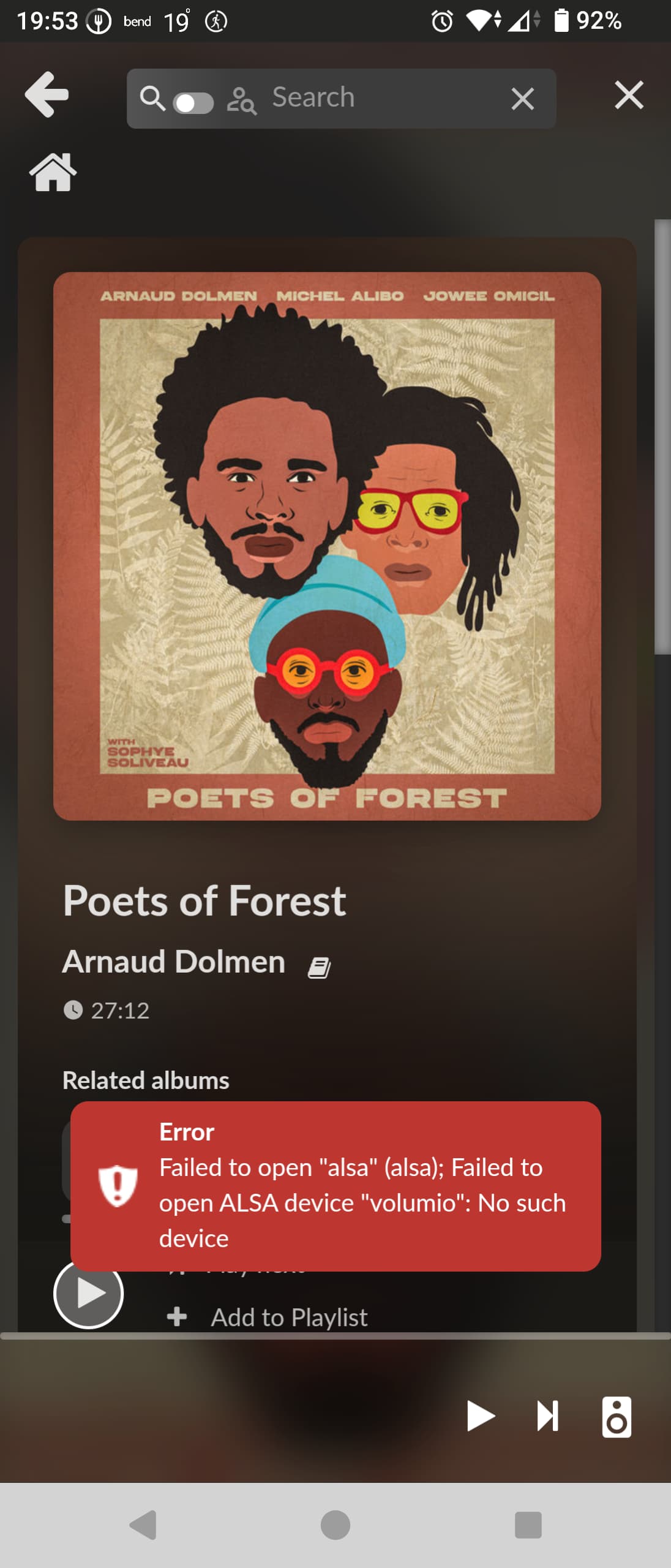

Got the same problem here. How do I reinstall Volumio. It would boot and show interface but when I click on play I get an error message.

You might want to check the audio output, disable multiroom, reboot and enable it again.
And if you want to reinstall you can go to system => system updates => factory reset.
