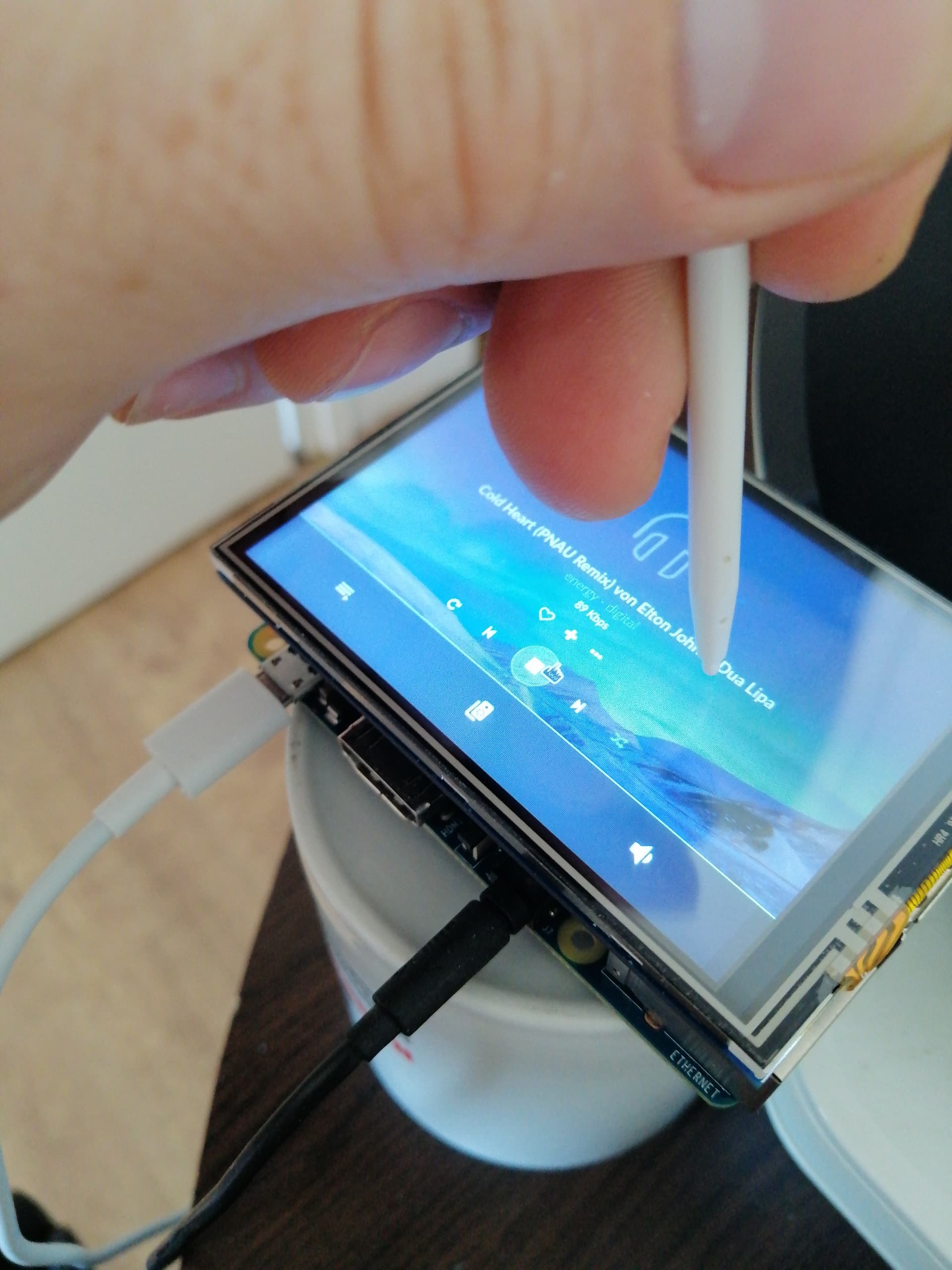

i tried since 2 weeks:)) now i have to change the touch input
because it do not work as intended.
wen i touch at the right corner it comes my profile on the screen.

Could you try to describe in more detail where the touch events happen when you touch the screen at certain positions, e.g.
“touched upper right corner => pointer appears upper left corner”
Also try to describe in which direction the pointer moves when you swipe vertically and horizontally.
the touch is okey a little bit of at the volume i have to touch near to the right to adjust the volume but it is okay,i had to reduce the scale to 80, and some time i have to turn the display ad 90 and than back at 270 and restart but seems to work just fine…

now the calib was way off but i turned the cursor on and just works ok,the another issu i have that i cannot rotate the display in any directions…
it always stays the same in landscape mode i mean the charger is in the left corner downwards.
For this display the rotation of the display cannot be set by the plugin, but you need to change the “rotate” value in
dtoverlay=tft35a:rotate=270
manually.
However, the rotation setting on the touch display configuration page should affect the orientation of the touch function.
