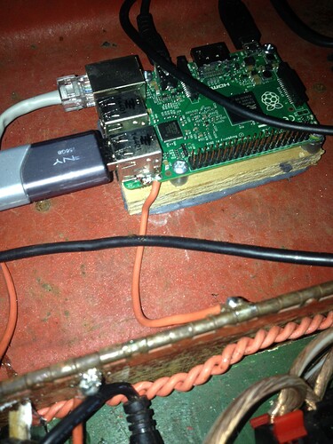

I fixed my popping problem by soldering a ground wire from a usb shroud on the PI to the ground wire of the power supply.
Picture? :slight_smile:
