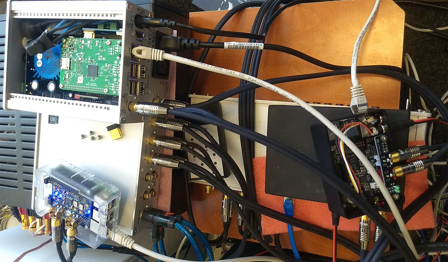

F**k me, judydudi that’s a decent LPS!
Thanks for the feedback and I am glad I asked as I assumed that you only used one Thel NT-25HQ with two USB connectors with 2x1,4A (1x2,8A) as per their website. Now I know why I stumbled over the term Dual Thel NT-25HQ :smiley:
I was thinking about a single NT-25HQ with 2x1,4A to run the system as it would work very well with the case I was considering for my player.
But looking at your rig I wonder if that would be enough. Did you ever try to run such a setup with only one NT-25-HQ?
I assume you use two LPS’ to have two truly separate power supplies, correct? Do you think using only one LPS would be far inferior to your setup (if the NT-25-HQ-09 is not potent enough the NT-50HQ-09 would come to mind)?
I would prefer to have the LPS within the case instead of sperate…
Thanks for your DACberry setup as well! I have to wait until the isolator is back in stock to test it…
One NT-25HQ is enough. even for the Katana which takes over 1,1A for their stack!
With one NT-25HQ you have two clean and independent power connectors. (2x 1,4A)
I put two NT-25HQ in that case for more flexibility, and to share one EMI Filter, to save money.
I was thinking about the NT-50HQ but there is no need. same noise spec. etc.
I want to give every device in my contest a single, independent power rail, to keep away any noise from each other.
My next stepp would be Black pulsar BLP25-09 - thel-audioworld.de/module/Cl … pulsar.htm
the disadvantage here is the heat and the continous consumption :wink:
