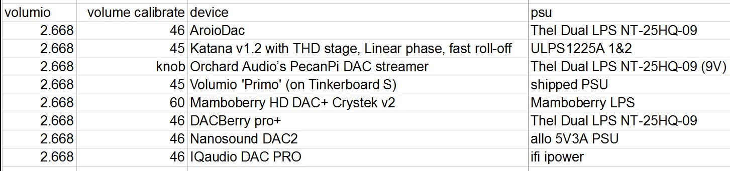

We did it again, yesterday!
we compared these boards in sound:
01 allo: Katana THD
02 Orchard Audio: PecanPi DAC streamer
03 Volumio: ‘Primo’ (on Tinkerboard S)
04 Nanomesher: Nanosound DAC2
05 OSA electronics: DACBerry pro+
06 Collybia: Mamboberry HD DAC+ Crystek v2
07 abacus: AroioDac
08 IQaudio: NEW PI DAC PRO
played on cambridge azur 651w amp and ELAC BS244.3 & FS78 loudspeaker.
One power supply has unfortunately turned out to be broken, so we had to improvise something.
Same Playlist as last time. Using RPI3B(+) and Tinkerboard.
We realized that all boards have a great sound. only minimal differences.
none had any trouble.
two boards were noticeably better:
allo Katana THD was liked most.
however, the AroioDac was practically just as good.
both were a step more precise, detailed and dynamic than the others.
Many thanks to all listening visitors.
And many thanks to all soundcheck supporters (allo, OSAelectronics, Orchardaudio, Collybia, Nanomesher and volumio)
The nanomesher products were here for the first time.
On the pic you see the nanosound DAC2 with amp (10W) and color 1,5"OLED. (a IR Remote is included)
They have a fitting case in their shop.
Unique is their Nanosound CD plugin.
Its avaible for different plattforms and also available without myvolumio subscription!
Summary.
Katana is indeed very good - but the right LPU is a must otherwise you are going to be disappointed.
AroioDAC is suprising good.
The DACBerry pro+ was last time better with a isolator.
Nothing against the other devices.
My next intend for a soundcheck is to “stress” more the opamps on DAC board.
using 90% volume level and a preamp… competitors.jpgSeat11.jpgoverview11.jpg

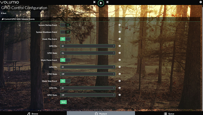

Hi Che,
yes, i used the isolator board from OSA.
The Thel PSU is set to two independent 5,25V connections.
( i have the Thel EMI Filter installed too. thel-audioworld.de/module/Ne … filter.htm EMI-306 )
In volumio using the OSA DACBerry ONE+ driver
DIP switch on Isolator to Master I2S
Power, one to RPI and one connection to Isolator. The Isolator is feeding the DACBERRY.
Installing GPIO Control Plugin and config as picture shown.
