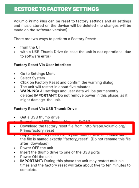

New to Volumio. Have you tried a factory reset
ofc I had done already
you know how to do factory reset of the primo plus when it is unreachable??
Manual?
Download link (Copy and Paste): http://repo.volumio.org/Primo/factory_reset
