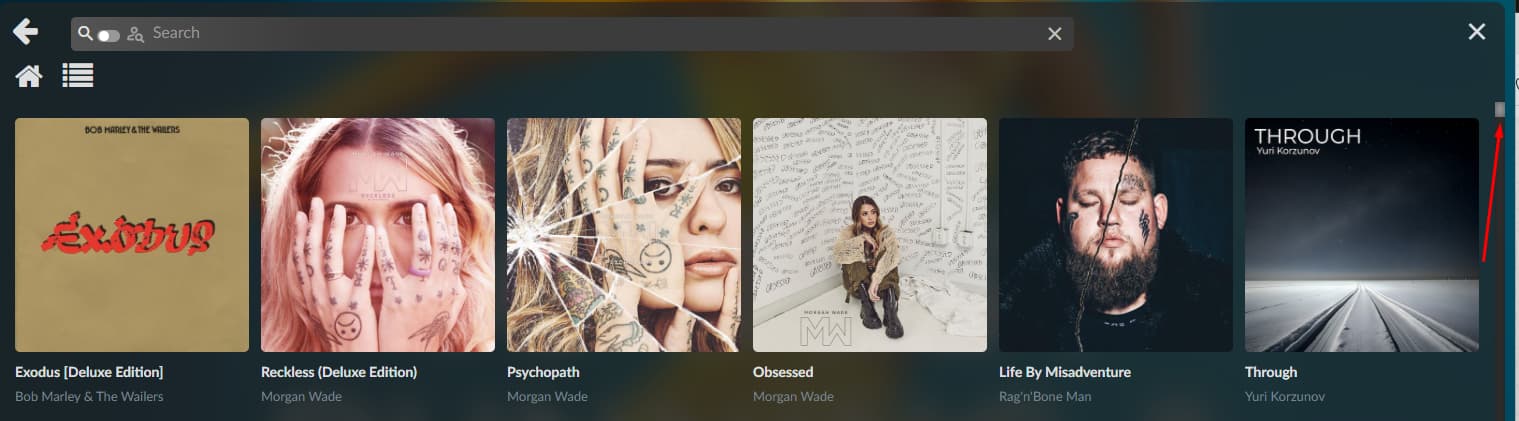

HI,

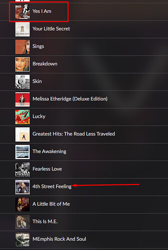

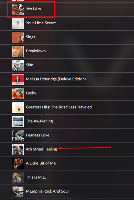

I am unable to reproduce this. As there are only 3 reports it doesn’t get high priority.
I’ve tested about 16 random albums (of 3500), but the it always return to the album list with the same album on the top of the list.

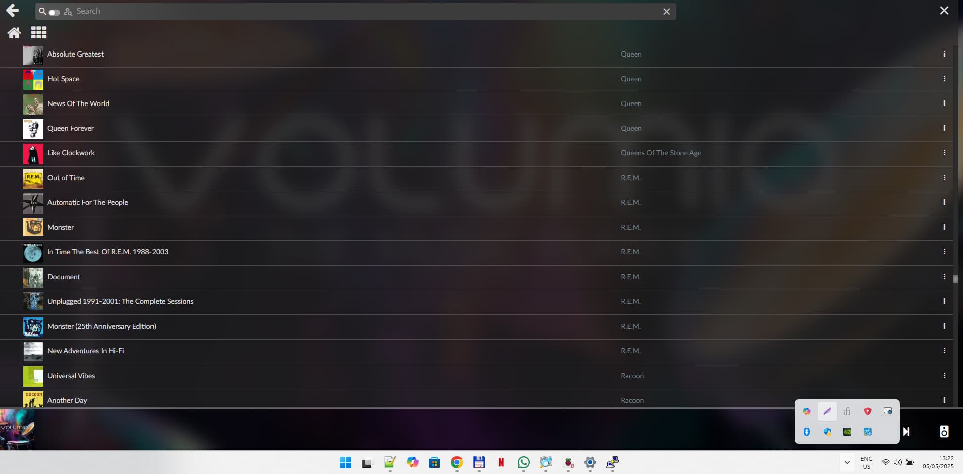

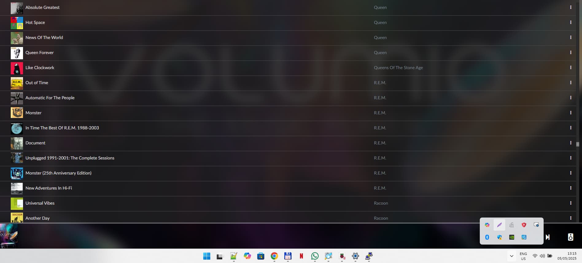

Not saying it doesn’t happen, only that I can’t reproduce the error:
Opened Unplugged 1991 - 2001
Waited for a couple of minutes (7):

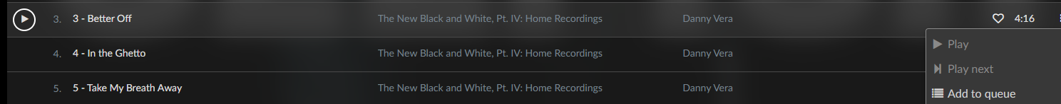

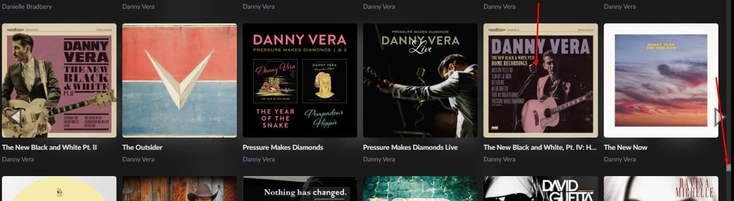

It happens when I add a song to the play queue and then go back to the album covers view. It happens most often if I don’t scroll back to the top of the tracks list. I can get this to happen on the app (both Android and iOS) and on a web browser. Will check if it happens when using the touch screen I have attached to my Pi4.
If I don’t scroll to top of tracks listing after adding a track to the queue (or a playlist) it goes back to the top of the album list.
It does not matter which album view I use.

Steps to reproduce:
- Go to album view
- Select a random album after a few pages down
- Add a track to the queue
- Use the white back arrow
- Volumio moves back to the top of the album list
With a very small libary it’s not a big thing, but with a big album list it hurt your scrolling finger.
