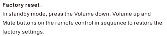

Just the obvious questions:
  • You have performed a factory reset on the E50?
  • Your DAC is not in preamp mode?
  • There are no plugins installed that interfere with the audio chain?

  • DAC was reset but still the same experience
