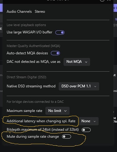

In the meantime, I have been wondering how to get around this problem.
Looking at how the RPi 4 behaves with Volumio maybe such functionality from Audirvana would help:
Bez tytułu
Is it possible to get this in Volumio? I couldn’t find this in any settings.
