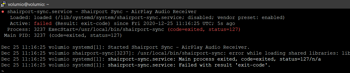

HI!
i do follow you but i see , i think it still wrong!
***● shairport-sync.service - Shairport Sync - AirPlay Audio Receiver
Loaded: loaded (/lib/systemd/system/shairport-sync.service; disabled; vendor preset: enabled)
Active: failed (Result: exit-code) since Fri 2020-12-25 11:16:25 UTC; 5s ago
Process: 3237 ExecStart=/usr/local/bin/shairport-sync (code=exited, status=127)
Main PID: 3237 (code=exited, status=127)
Dec 25 11:16:25 volumio systemd[1]: Started Shairport Sync - AirPlay Audio Receiver.
Dec 25 11:16:25 volumio shairport-sync[3237]: /usr/local/bin/shairport-sync: error while loading shared libraries: libssl.so.1.0.0: cannot open shared object file: No such file or directory
Dec 25 11:16:25 volumio systemd[1]: shairport-sync.service: Main process exited, code=exited, status=127/n/a
Dec 25 11:16:25 volumio systemd[1]: shairport-sync.service: Failed with result ‘exit-code’.
Maybe you can try this:
ln -s /usr/lib/arm-linux-gnueabihf/libssl.so.1.1 /usr/lib/arm-linux-gnueabihf/libssl.so.1.0.0

Ah, that is interesting – can you tell me what the ouput of
$ cat /etc/ld.so.conf.d/arm-linux-gnueabihf.conf
$ ldd /usr/local/bin/shairport-sync
$ /usr/local/bin/shairport-sync --version
I think he mean this Volumio Debian Buster Beta - Raspi images debugging - #274 by ashthespy? – that should have the steps to get the shairport-sync service up and running.

To help fixing the problem i need to install shairport. But it looks like “mac” don’t wan’t my help :crazy_face:
There are missing librarys, link them and it probably will work :grimacing:
Nah, I guess he was trying to be helpful and respond your previous comment here

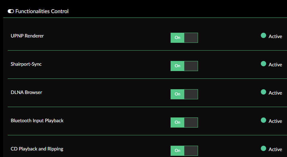

Either way - shairport-sync should be already installed, just the service to start it from Volumio’s side was disabled as it was giving some issues in much earlier builds with dependencies. That should be fixed now, but you need to add the service manually.
What makes things a little confusing, is that on a fresh build (not yet released) things seems to be working fine
