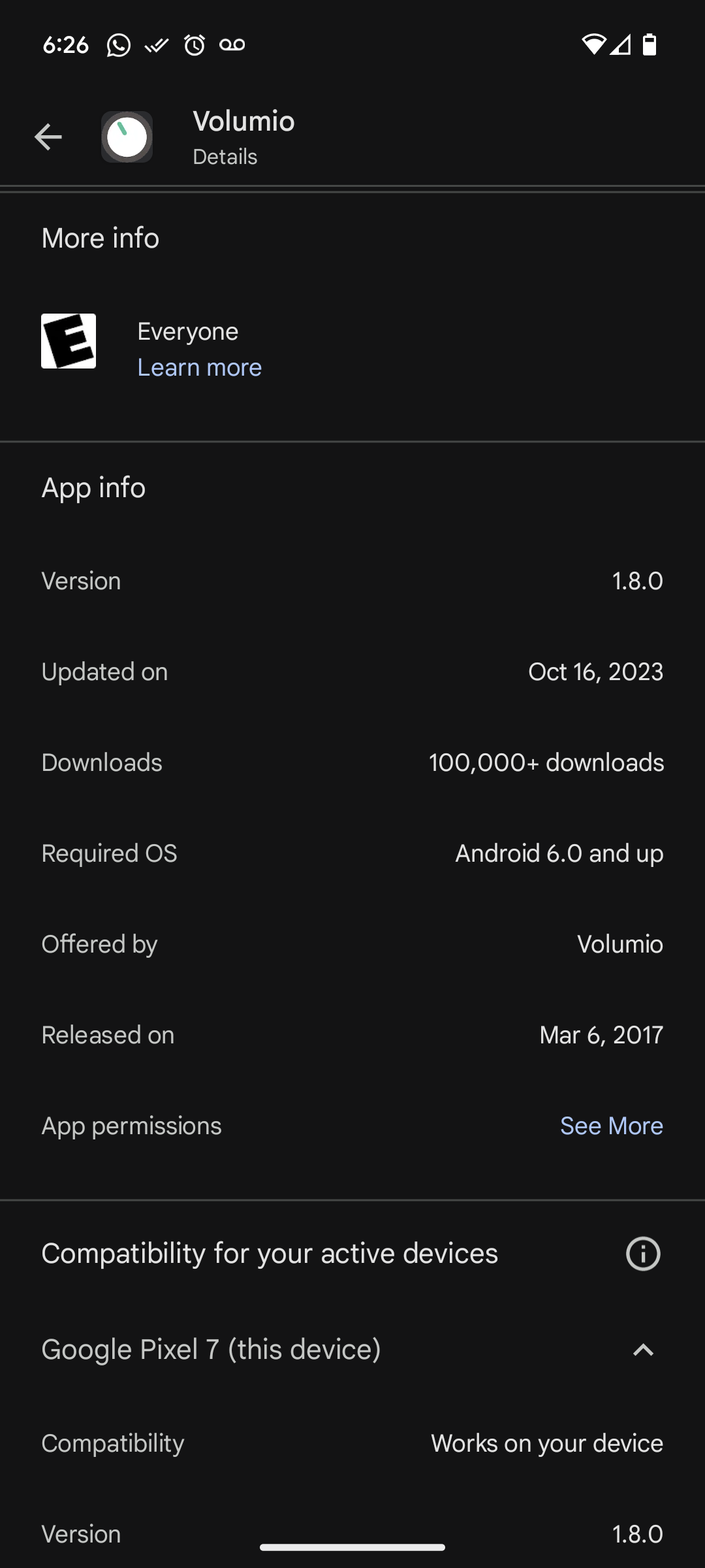

I see that the last app update was in October 2023, right around the time my devices were not being discovered by the app anymore.
