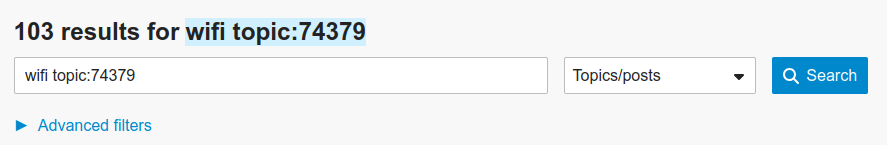

@Wheaten - for me, I have read all the topics on wifi - but what is the solution when I am not able to update the device? I have no ethernet board in my Zero 2 W - and wifi is not working.
