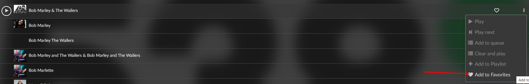

Add favorite:

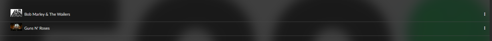

Volumio Favorites:

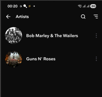

Tidal app:
