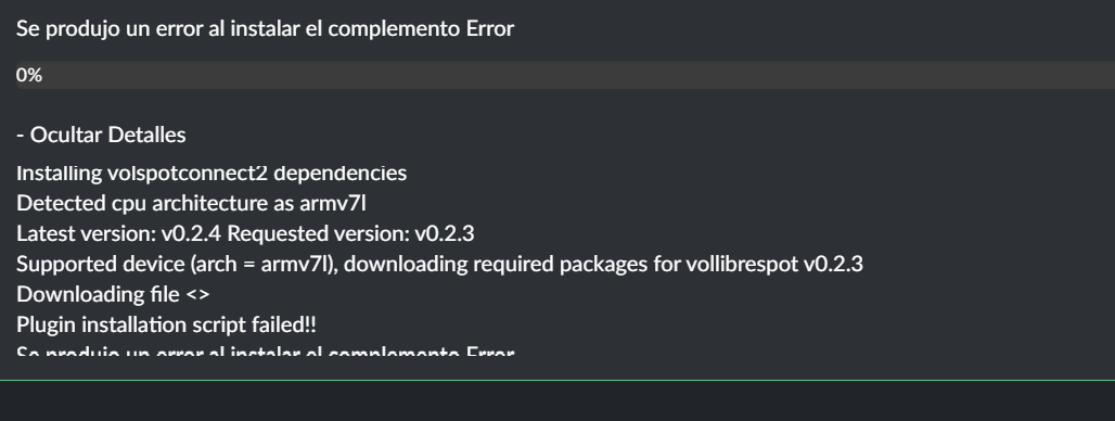

I’m happy to wait, but as it appeared there I thought it would be available. that said, I appreciate v3 isn’t released yet, so I just wanted to alert the dev
Ah, sorry I see it’s the Spotify Connect plugin, not regular Spotify - my bad!
