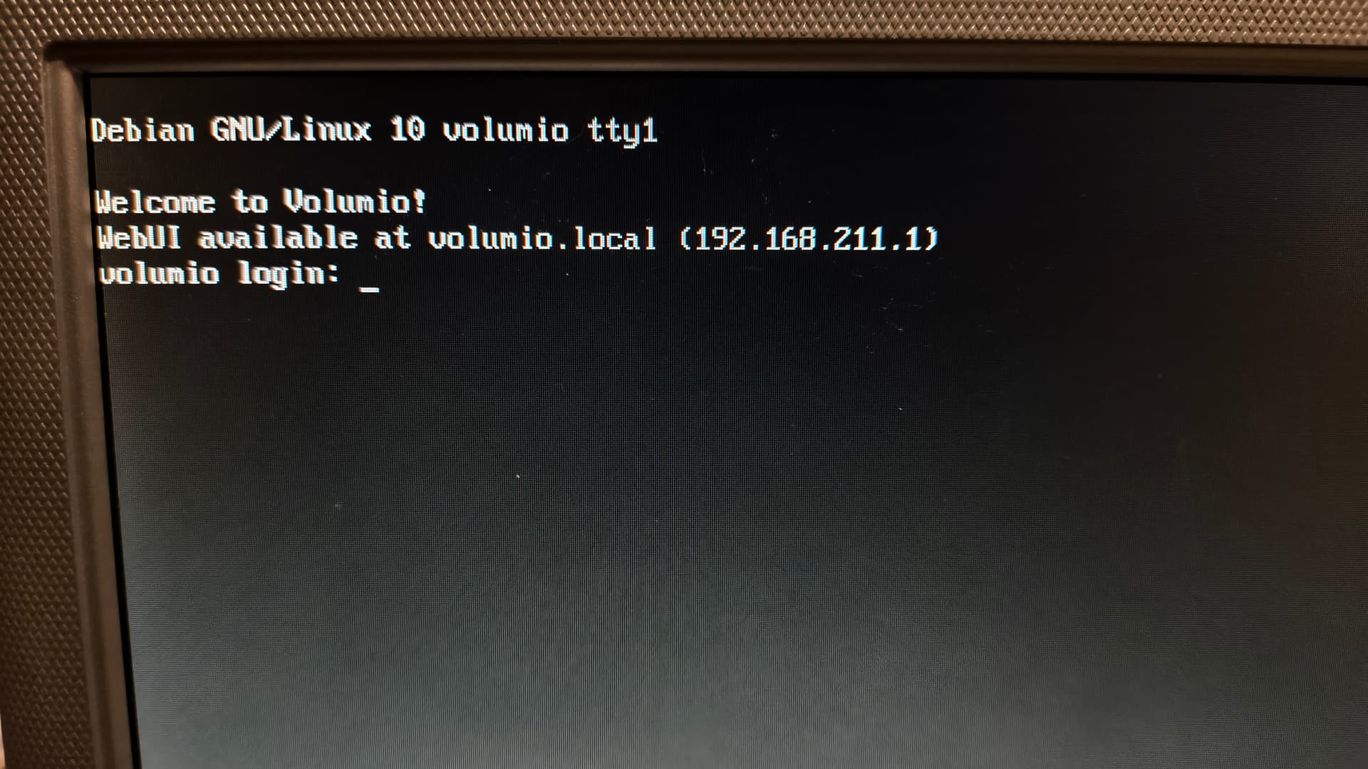

I understand that the topic has not been active for a long time, however, I have a problem and I hope for your help.
The background… 3 years ago, I bought an orange pi lite board and put a Volumio 2 shell on it.
I don’t remember which version, but it worked stably for several years until I decided to check the update from its interface and foolishly upgraded.
The crux of the problem is that after updating and restarting Volumio, a screen appears on which you need to enter your username and password (as I understand it, it should be volumio) I enter my username, press Enter, a password field appears, and then, for some reason, pressing the letter keys, they are not entered! The cursor flashes when the keys are pressed, but no letters are entered…
I’ve tried installing different versions of volumio 2 and volumio 3. The same login and password screen appears on startup. No Wi-Fi network is created at this stage.
Please help me figure out this problem.
Why are the letters not entered when entering the password?
How do I launch the volumio interface?
A board with 1 GB of RAM.
I will be glad for any hint! I would like to thank you in advance for your help!
