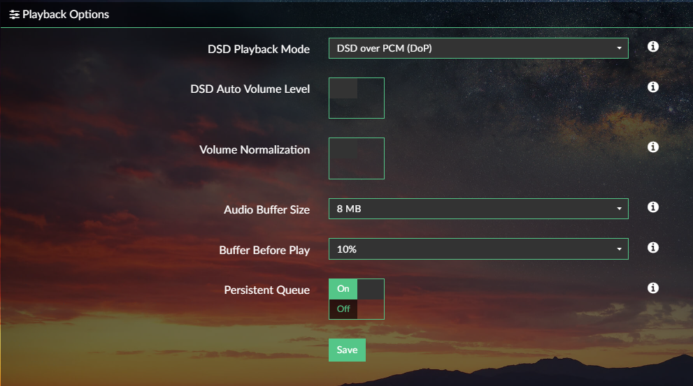

One minor glitch I’ve noticed with the UI is that toggle boxes do not display correctly. I don’t recall if this was the case on the 09-07 build, but pretty sure it wasn’t there on an older 3.14 kernel build. See the three on/off toggles in the attachment. Is this a known problem ?

It is highly unlikely that the toggle box issues are related to the kernel version, you might have to drop a question in the help section.

I wasn’t suggesting that the kernel was responsible for toggle box issue. Just pointing out that the toggle box issue was not there in the older build (in this thread) that contained the 3.14 kernel as I ran that version for quite a while.
I assume that you are building the latest development version of Volumio each time you make an image, thus later builds include a slightly later dev version of the volumio base system, not just kernel changes ?
Yes, central builds are always with the latest Volumio version.
I checked your issue a few minutes ago (as I was focussing on the kernel, not on Volumio), but cannot confirm it.
It works correctly here, used Firefox, Google Chrome and Safari.
Could it be you were building a library and the screen was not refreshing properly during that time?
