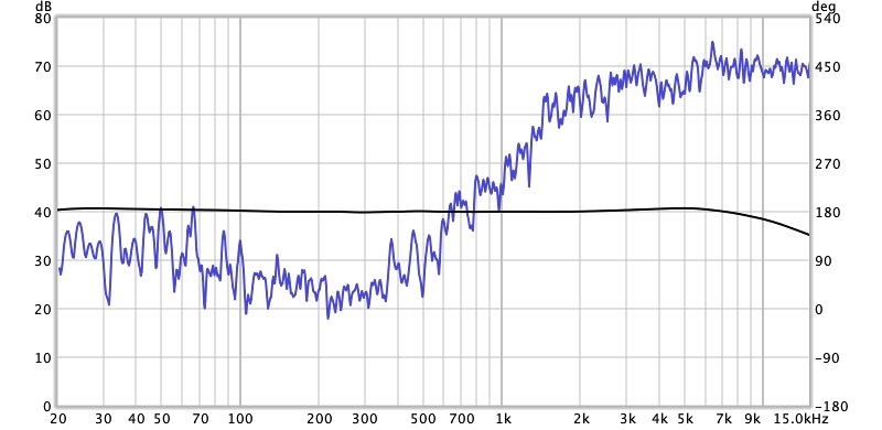

I’m trying to create filters with REW and RePhase, but I have a problem when playing sweep signal trough volumio and BruteFIR plugin, the graph of the recorded sweep starts very low in the bass/mid range and rising at the high range, when I play the sweep trough REW then all look normal.
Have I done something wrong? To my ears the signal sound’s ok.

Hi!
What is the version of REW your are using? need to investigate

I’m using REW version 5.20 Beta 23. And I using an Umik-1 as microphone. all running on a mac
left.jpgThis i what a sweep looks like
When I change the sample rate from 48kHz to 44.1 kHz, then is ok.
/Lars
I was writing you to check this! So, good!

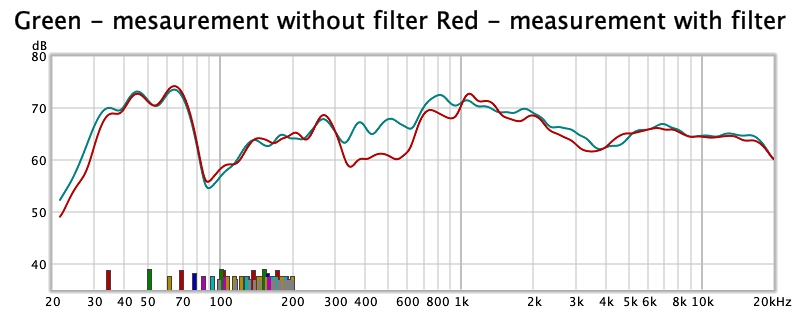

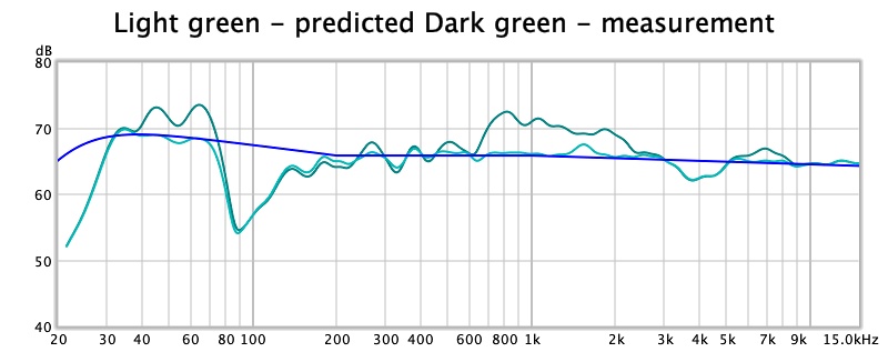

Did my first filter, the result was not as I expected, maybe I have to do some more homework :smiley:
Predicted:
Measurement:
The other speaker is similar. Have used REW and RePhase, any tips is much appreciated.

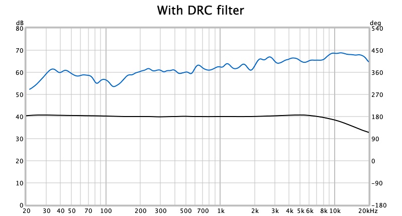

Now thing start to looking good. Tried to make a filter with DRC and a very simple target curve.
I have to do some more work on the target file. But I’m on the track i think. I’m not sure how to use the Input Attenuation.
I have to thank you balbuze for this great work. Very impressive. Keep up the good work.
/Lars
Good! Attenuation must be a least equal to the maxi correction you have done. If not you’ll experience clipping. Check with sudo journactl -f to see if the problem occurs. Let me know.
