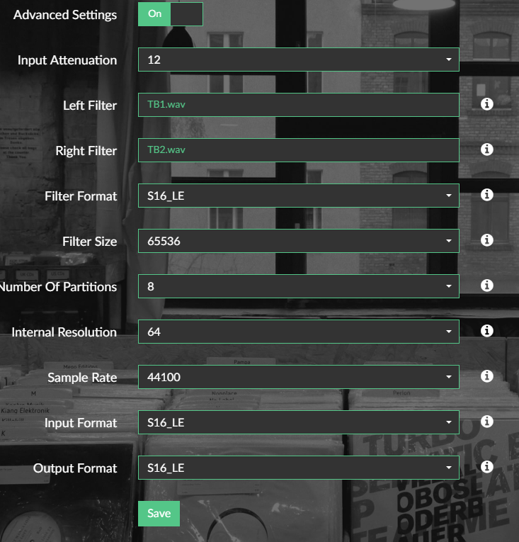

Hello together,
I have a problem to get my filters working. With the test filters everything seems ok, with my filters I only get short distorted sound snippeds. My filters and my config are attatched. My filters are made with Acourate, i can save them in wav (single or double precision). I hope we find my obstacle.
Best regards from germany
Thomas

Oct 07 08:14:22 volumio volumio[9492]: peak: 0/15808/+16.60 1/15737/+16.37
Oct 07 08:14:22 volumio volumio[9492]: Safety limit exceeded on output (20.47 > 20.00). Aborting.

Try to increase “input attenuation” to at least 18dB because your filter generates :
Oct 07 08:14:20 volumio volumio[9492]: Audio processing starts now Oct 07 08:14:22 volumio volumio[9492]: peak: 0/15808/+16.60 1/15737/+16.37 Oct 07 08:14:22 volumio volumio[9492]: Safety limit exceeded on output (20.47 > 20.00). Aborting.
So you get clipping and distorsion
let me know
