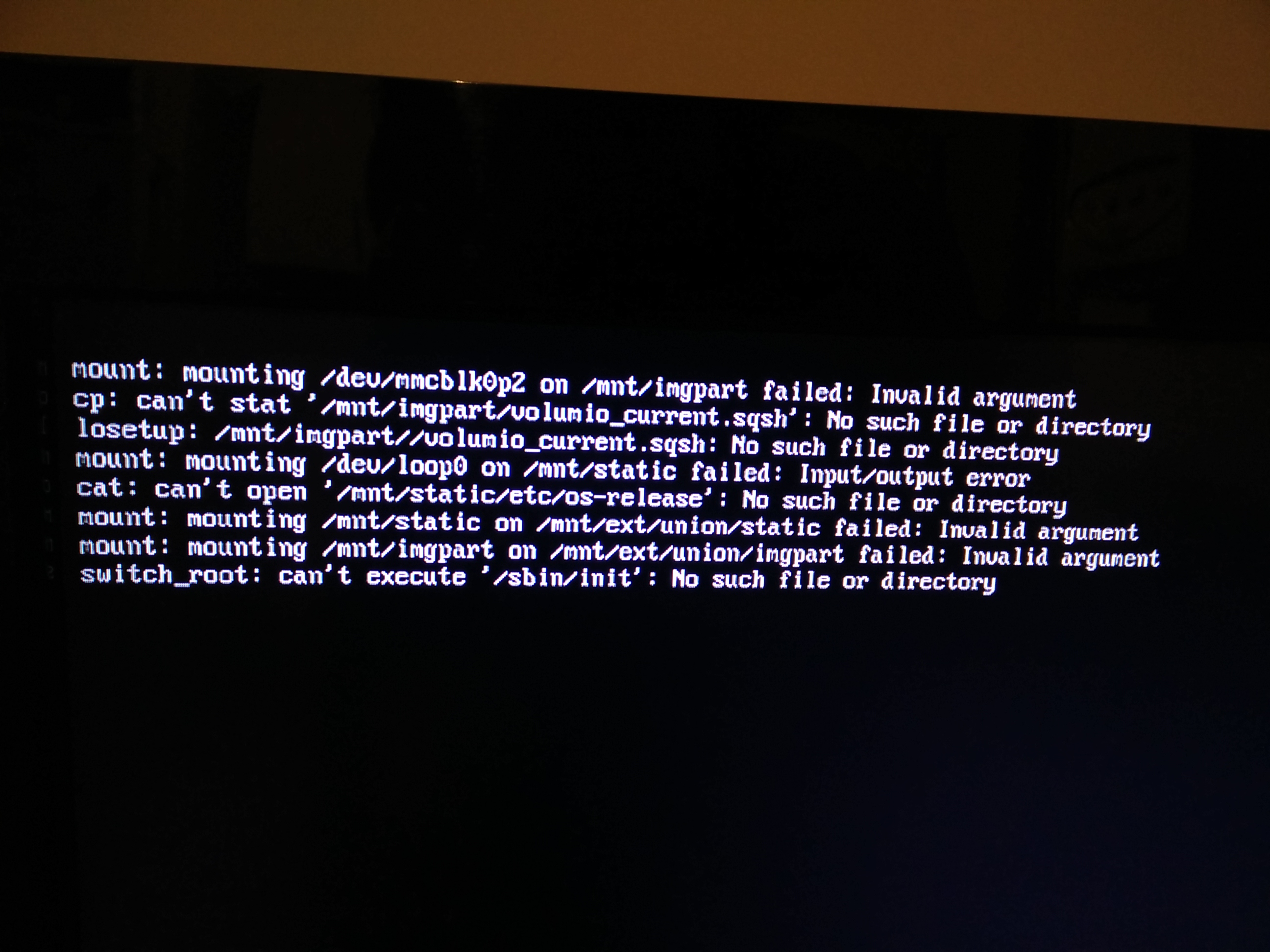

Same here with a Raspy Zero W.
The update was ok but after the reboot it was dead.
I connected to a display and it says it cannot mount some stuff.
I think I have to reflash :angry:
