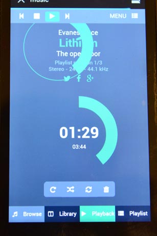

Hello guys!
Thanks Michelangelo for great work!
I have RPi B+.
Volumio looks fine on my computers and tablets, but smartphones.
I have extra circle on the top of the screen.
Is there any way to avoid it?
