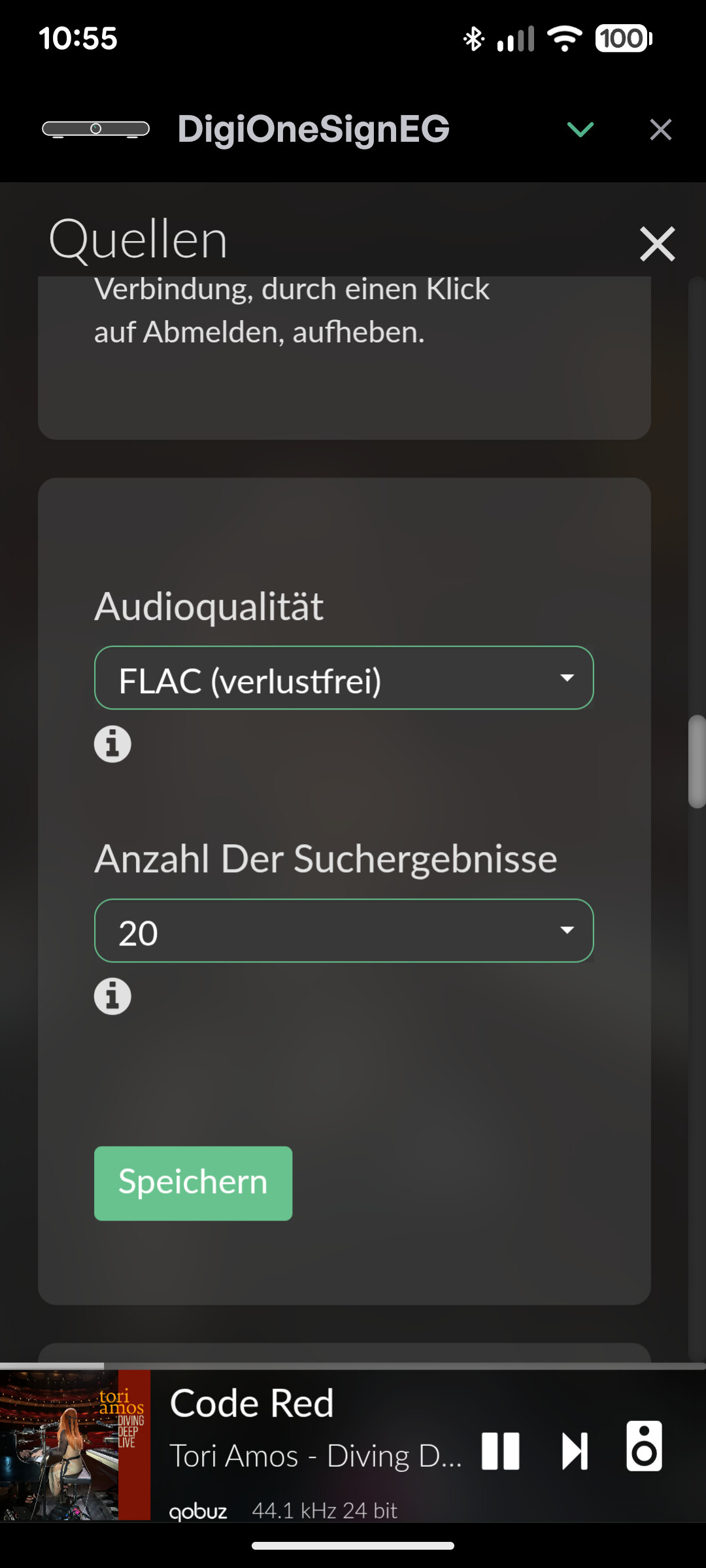

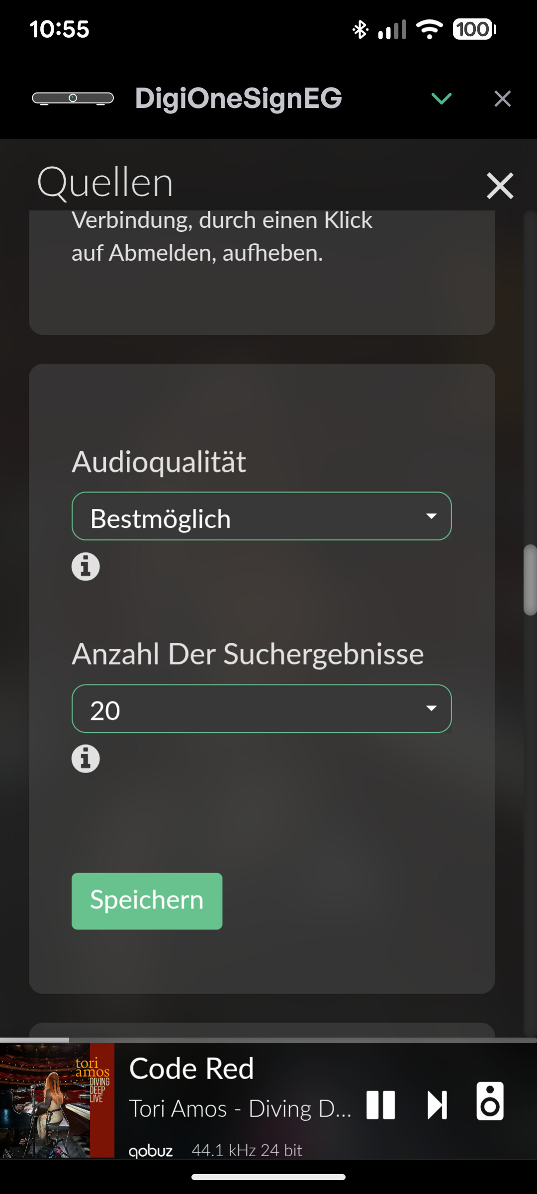

The error only occurs with high-resolution tracks (24-bit).
If the audio quality in the sources is set to “FLAC Lossless,” the error doesn’t occur (44.1/16-bit).

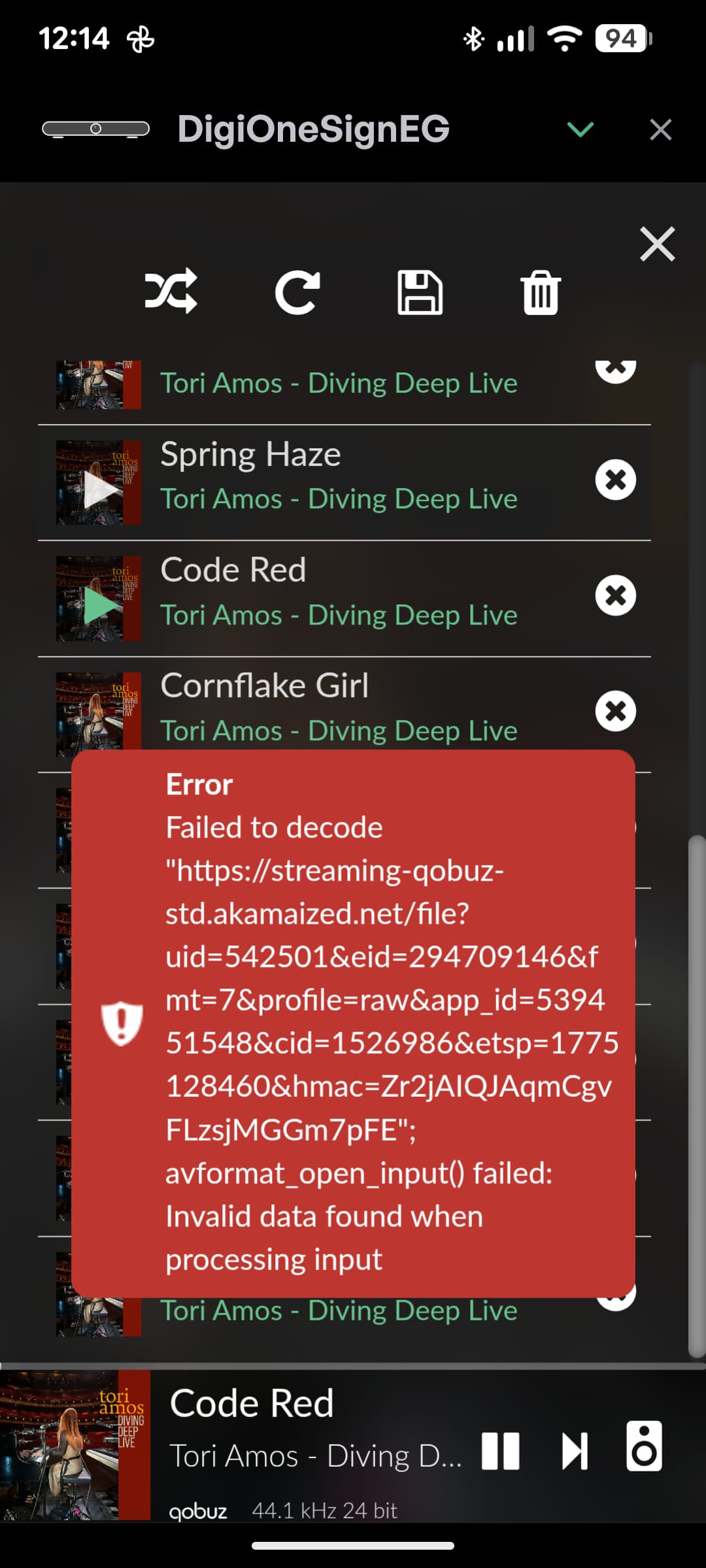

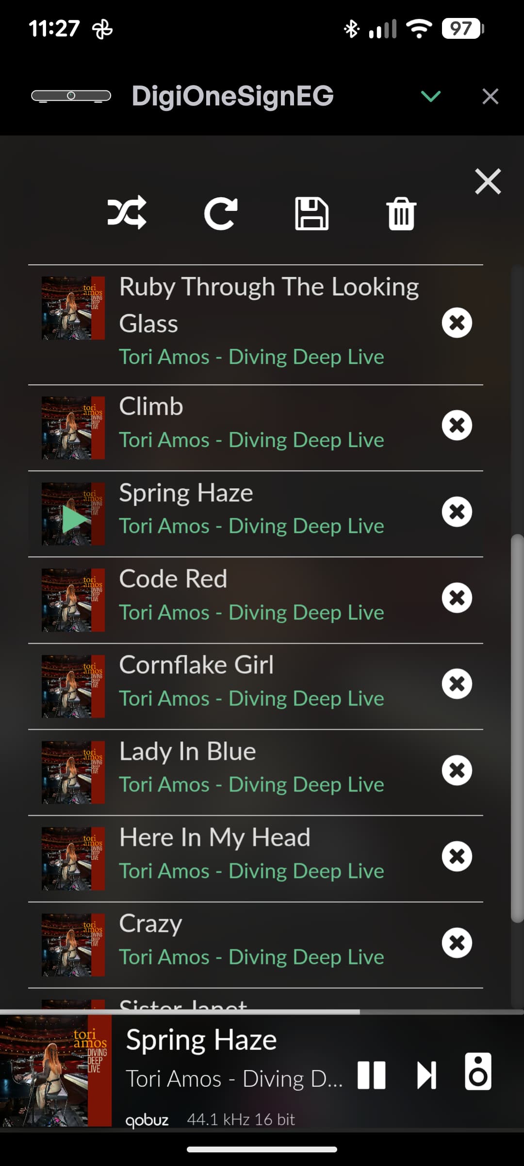

Volume is sometimes unable to play 24-bit tracks in Qobuz.
It skips these tracks and plays the next one that is compatible.
The same issue also occurs with Qobuz Connect and the same tracks.
Also on RPI systems. (Volumio 4.119)

Here with the source set to Best Possible (Problems)
Here with the source set to Lossless FLAC (No Problems)
