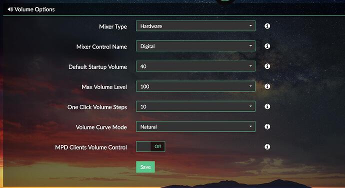

@volumio startup volume is bad it starts on 100% while the settings are set on 60%
and this is with all dragonfly’s black, red and cobalt…with all versions of volumio on rpi and sbc board
so it seems a code problem…
